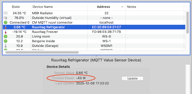

Here is a screenshot of what I what I see today. I am using the hard-coded power load property to display signal strength. I would like to change the label to something other than "Current power."

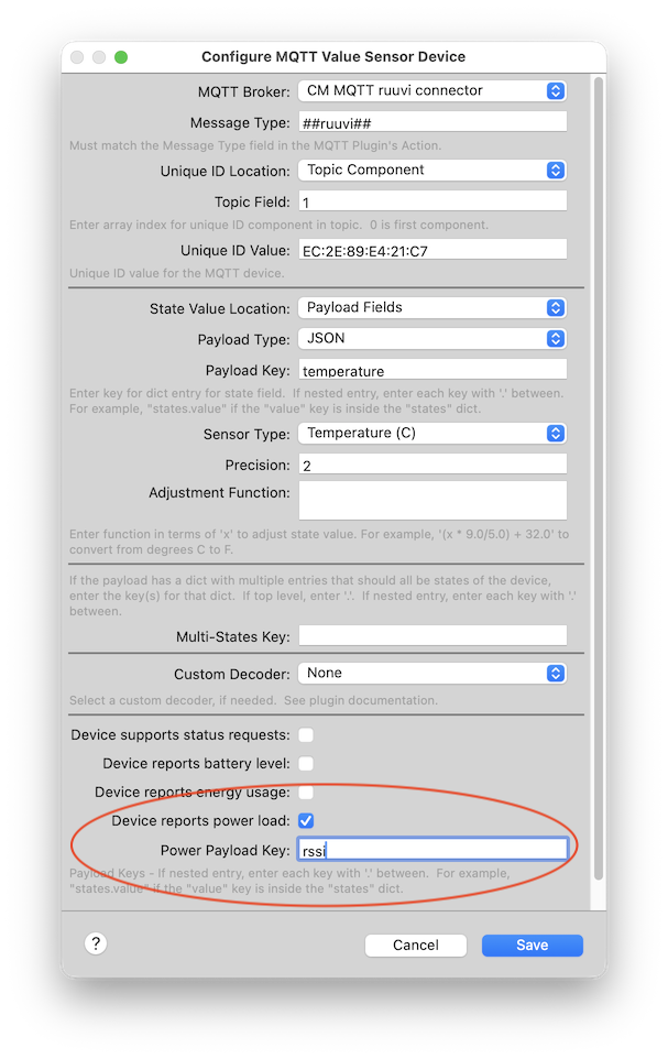

Post a screen clip of what you see in the UI (where you want to change the label).

FlyingDiver wrote: Sat Dec 06, 2025 6:33 am Post a screen clip of what you see in the UI (where you want to change the label).

That’s generated by the Indigo client. I could change the units displayed, but not the label.
The right way to do it is to create another sensor device just to display the rssi value.
