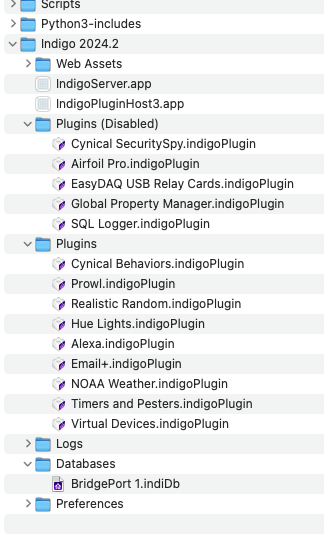

So a couple years ago I had HomeBridge installed but now I'm trying to move to HomeKitLink to regain that functionality. I've never had HomeKitLink installed before now. That said I looked through the plugins and preferences files located in the preceptive Automation folder in libraries: There is no reference to HomeKitLink... only HomeBridge.
I'm not completely sure I'm staring at the right location: Screenshot attached
Thank you.
Thank you.
- PastedGraphic-1.png (59 KiB) Viewed 568 times
-Al
