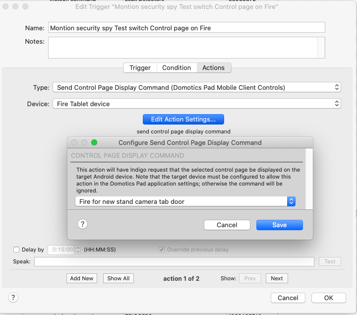

A few years ago I did something like that - trigger fired and it switched to a different control page with the video, then it switched back after a set time. Let me see if I can find it…
Used trigger (see below) to switch control page - then next action delayed by 50 seconds send it back (same action a first one but points it back to the original control page).

This was my first thought too. But the video feed is not a control page, and can't be imbedded in a control page, unless I'm missing some other trick there.
