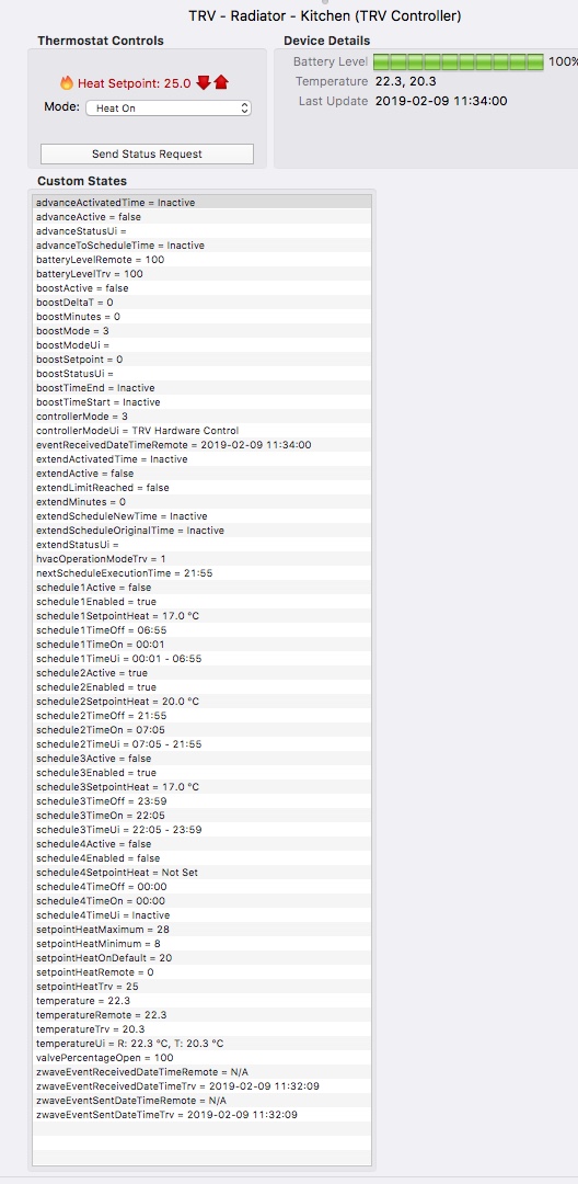

Maybe I am just misunderstanding the Plugin.
The rooms I have run by this plugin are very warm indeed!
An example the Kitchen.
Still delivering Heat when both the TRV and the external Thermostat are reporting over the target of 20C

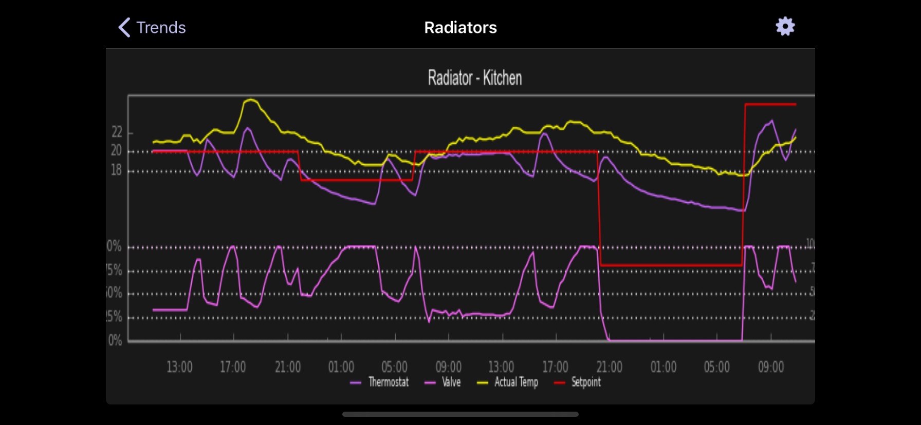

This is graph of events over the last couple of days
- TRV9.jpeg (149.01 KiB) Viewed 3108 times
Couple of questions.
Are you using remote temp sensor with Delta set to 5 degrees?
Could you also plot the TRV setpoint as well as the thermostat plugin device.
Finally it's showing that your trv is in hardware mode, have you pressed buttons on the TRV?
Yes
Will do
Nope not touched a button on TRV since Inclusion and initial setup
BTW found the issue with the repeating error
All my fault {Blush} - worked it out
Yes
Will do
Actually I am plotting the TRV Setpoint it is the Red line on the graph

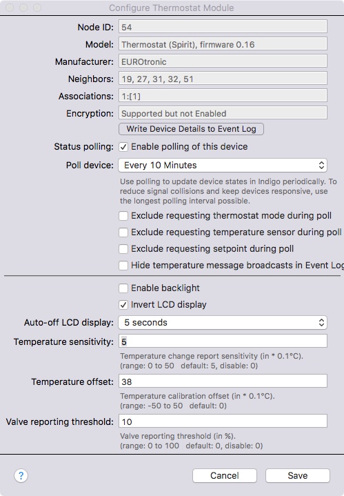

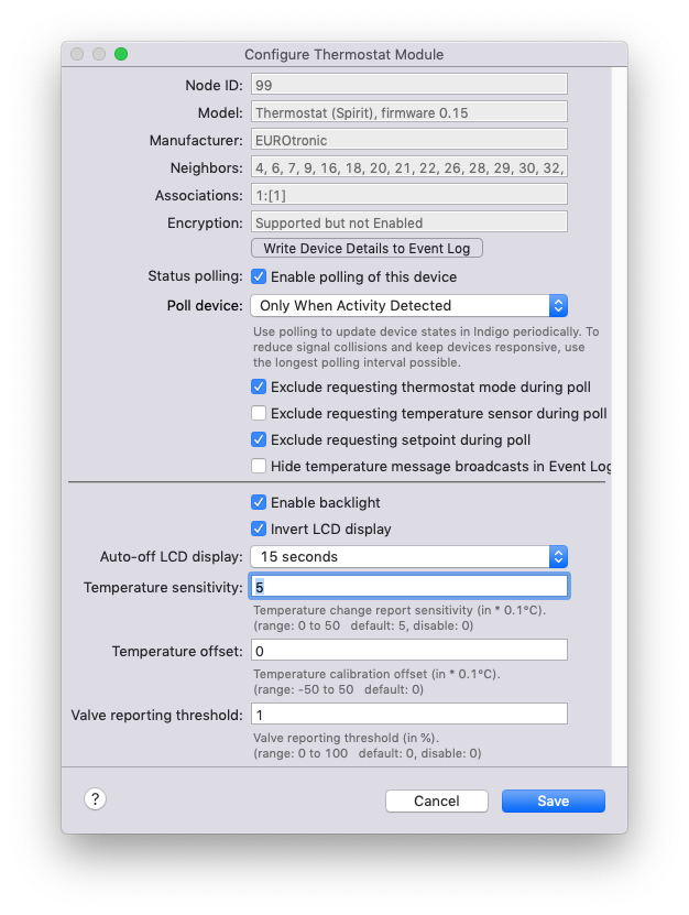

This is a useful bit of testing, can check that your Spirit device settings are setup as follows: I suspect what is happening is that when the Spirit returns the Setpoint (which isn't needed by the plugin), the plugin can't tell whether that is the result of a poll or whether a physical button has been pressed. I suspect that is why it is showing it as being in TRV Hardware Mode.
re: previous post - you need all your Spirits to be setup the same way. Once all changed, reload the plugin to start with a clean-slate.
I will look at putting in a check for the required Spirit parameters and warning if not correct.
I will also add these requirements to the documentation.

This is how it is setup now.
