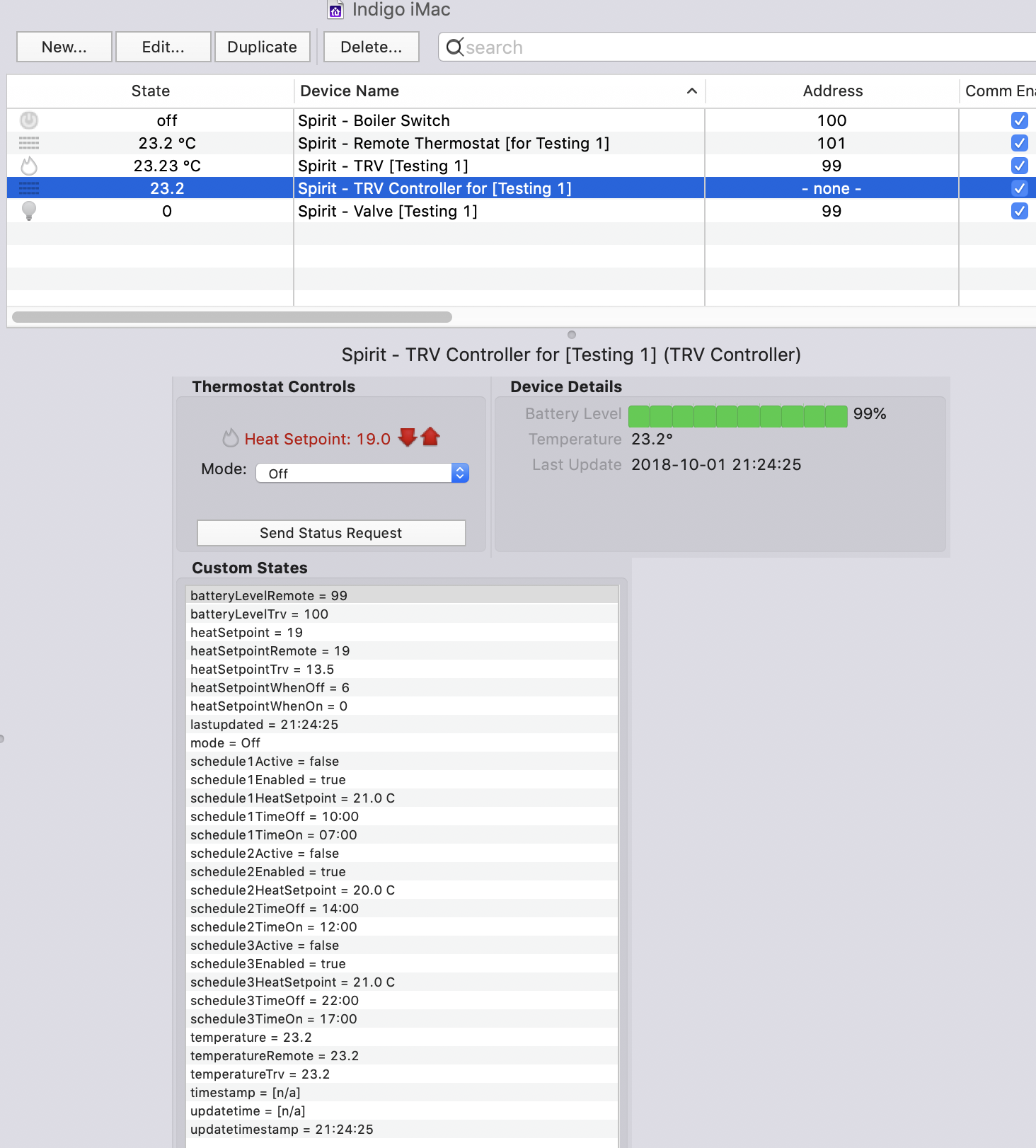

Further progress made today :) :
TRV - Sample 2
TRV - Sample 2
TRV - Sample 2.png (627.39 KiB) Viewed 9844 times
This plugin differs from the Stella-Z plugin in that the controller device (i.e the device controlling the TRV device) is setup as an Indigo Thermostat; so all the standard Indigo controls and viewing options are available to the controlling device. The battery level is derived from the controlled TRV and/or Remote Thermostat - the plugin uses the battery level value from the device (TRV or Remote) with the lowest value.
Still some rough edges to sort out on this phase of the development but the TrV Controller device now accurately tracks the controlled TRV and Remote Thermostat devices i.e. temperature changes and manual adjustment of the devices.
Next update is likely to be in a few days away as I am busy for the next couple of days. :)
