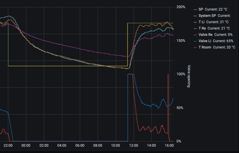

I started using Grafana to check what's going on with temperatures, setpoints etc. I noticed something odd in a room where I have two radiators with a thermostat on each of them. You can see in the graphs that the left and right radiators (li, re) are at/above 21 degrees, which is the setpoint for the room. But why are the valves still open, and quite far at that?

Are the plugin devices using the TRV temp or the room temp with external sensors?
Presumably their own by the set point comment.
The valve will learn to an extent what % to be open to ensure the temperature remains constant. Either they have more to learn or one side of the room gets cooler than the other quicker and needs more top up of hot water than the other one?

The setpoint temperature is the TRV device state.setpointHeat. I have a variable that I set to the desired room temperature. When the variable changes, a python script adjusts both het setpoints to the same value as that variable. Hence, the two setpoints are always equal.
Both thermostats are in a similar place in the room; under one of the two windows. The temperature values are drawn from the TRV device themselves (state.temperature), and the valve comes from the thermostat device itself (a Spirit). The short purple line one the right side (temp sloping upward slightly) indicates the temperature in the center of the room, but that is not relevant in this problem.
(The heat source is controlled by a NEST thermostat that regulates my boiler, and the NEST gets a heat setpoint equal to the highest demanded temperature in the entire house.)

The valve opening is controlled by the Spirit. So as Simon says, one is calibrating slightly different to the other.
Are you using the TRV controller plugin, or just controlling them yourself?

Look at for much faster the Re TRV responded compared to the Li one. No wonder they use different %.
Set them both too 1% for now and show this chart tomorrow once the room has got cold then reheated.

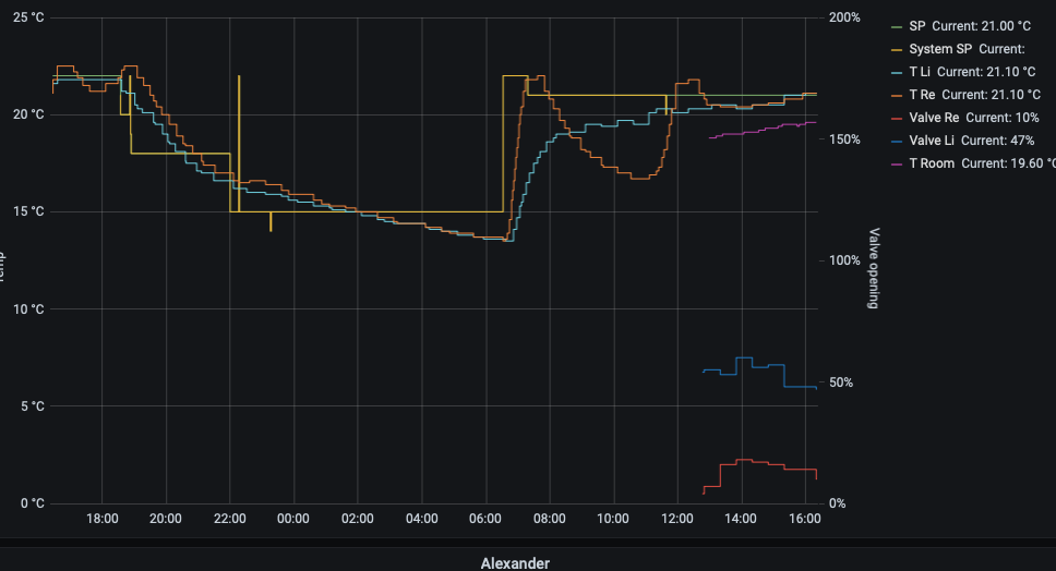

Here is a new graph. It is hard to see, but at 11:30 the setpoint was increased to 22C, and at that time the L and R stat temperatures were both about 14C. A separate temperature sensor far away from the window measured about 16C at that time (purple).
The right Spirit, which is located in a corner and with a bunch of boxes surrounding it, is heating up relatively fast. Its temperature settles fairly quickly at the setpoint.
Interestingly, the left Spirit temp and valve colors are cyan and blue. After a short period of 100% valve, the valve closes but after four hours, the temp is still not at the setpoint. It looks like the valve reacts properly to the measured temperatures, but the effect is not as strong as it should be. Maybe this is a case where I should adjust the temperature offset on the Spirit device. I will give it a shot and report back.
EDIT: Actually, the temperature values do not need an offset, as shown by the measurements during the night and early morning.
