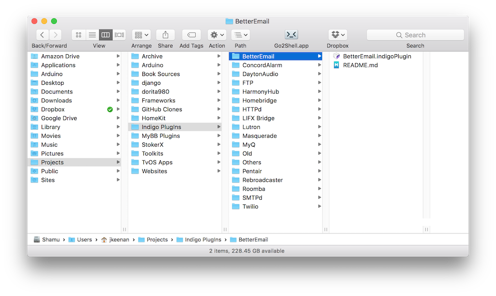

Re: Enphase Envoy-S Solar Power Plugin (with Panel Monitorin
Here's what my folder structure looks like. The "BetterEmail" folder is the git repository. The symlink from the Plugins folder points to the BetterEmail.indigoPlugin folder. If PyCharm has a problem with that, then just don't use PyCharm to push updates to GitHub. There are lots of Git clients out there.
Screen Shot 2016-12-20 at 6.09.01 PM 12-20.png (245.13 KiB) Viewed 19992 times
GlennNZ
Posts: 1873
Post by GlennNZ »
FlyingDiver wrote:Here's what my folder structure looks like. The "BetterEmail" folder is the git repository. The symlink from the Plugins folder points to the BetterEmail.indigoPlugin folder. If PyCharm has a problem with that, then just don't use PyCharm to push updates to GitHub. There are lots of Git clients out there.
Thanks Joe
Will restructure folders/files - presume PyCharm shouldn't have problem with it.
Glenn
