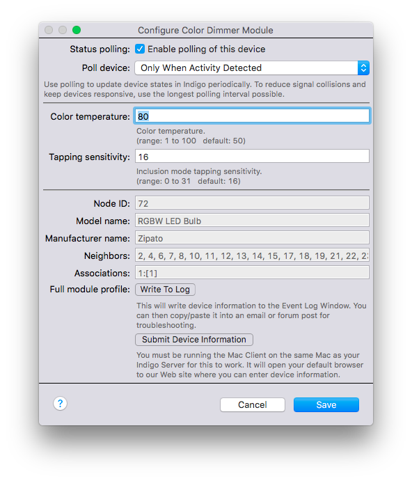

haavarda
Posts: 702
Location: Norway
Re: Can this plugin work with another RGBW device
Post by haavarda »
I set it in the edit device settings...
Skjermbilde 2015-10-20 kl. 21.03.47.png (114.57 KiB) Viewed 6596 times
Håvard
haavarda
Posts: 702
Location: Norway
Post by haavarda »
....And the strange thing is that the color temperature adjusted there is only reflected when using the slave device. When using the "white" field when setting a rgbw value there is a different color temperature.

Thanks for your help! Please let me know if there is anything that I can do to help...
Thanks... more information is better than no information. I can work this one through for you. Let me look at it in the morning and I'll come back to you!
Regards
Mike
