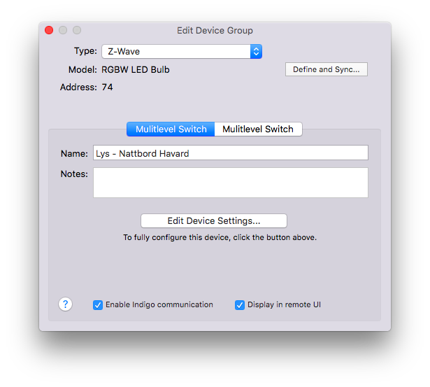

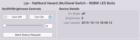

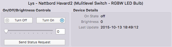

Hi Mike.
The range is 0-100.
If you see the screenshots you can see how device UI appears. The two different sliders is a bit confusing as it seams as if the first controling the rgb and the second is controlling the withe led.
Thanks for looking at this :)

Are there two separate devices?
Yes. It is displayed as a Device group in Indigo. One master and one slave. If I edit the master I can adjust parameter 1 (Color temp). The slave only shows information. Address, name and manufacturer. The Master controls the dimming of the RGB (0-100) and the slave controls the dimming of the white (0-100).
Are the addresses the same?
Yes. So in my case they both have adress 72
Are the device codes different?
Not sure what you codes are, but if you are thinking of device ID this is different for the two devices.
What is the model description for the devices (so I can search for bulbs in the devices list for the dropdowns)?
Multilevel Switch - RGBW LED Bulb

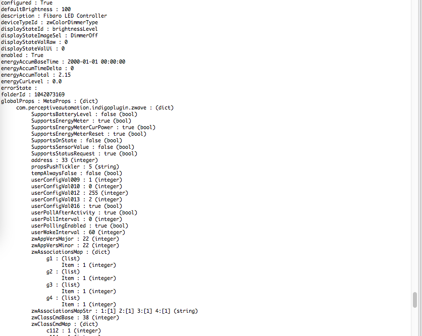

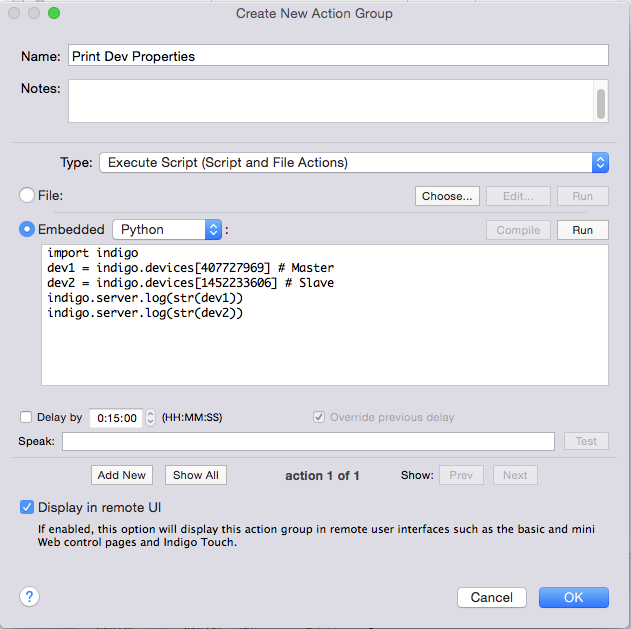

Just one more thing. I need to know how Matt & Jay have configured each device so I need to have the properties.
It's easy enough.
1. Write down the ID code for each device
2. Create an Action and select Server Actions, Execute Script
It should look like this:
Action group for properties
Screen Shot 2015-10-20 at 19.13.40.png (80.11 KiB) Viewed 6061 times
Enter some code in the embedded python box...
import indigo
dev1 = indigo.devices[ID of the Master Device] # Master
dev2 = indigo.devices[ID of the Slave Device] # Slave
indigo.server.log(str(dev1))
indigo.server.log(str(dev2))
In the screen shot above you can see that I've added the actual ID numbers into the indigo.devices[] area.
3. Click on Run
4. Look at the log and you'll have a dump of all the configuration information that Matt & Jay have created for your device.
Mine looks like this:

Now I'd like you to cut and paste all of the information in the log and send it to me :D
If you find that there is too much information (because there is a lot of it) i suggest that you run the code twice once for each device.
i.e.
import indigo
dev1 = indigo.devices[407727969] # Master
and then
import indigo
dev2 = indigo.devices[407727969] # Master
Substituting your id numbers for each device in turn.
Once I've got that information it's a fairly simple exercise to create a new device type for your Ziparto Bulbs... Then I might buy some :D
I'll need you to test it when you have the chance but I don't think it'll take too long.
Mike
