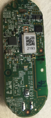

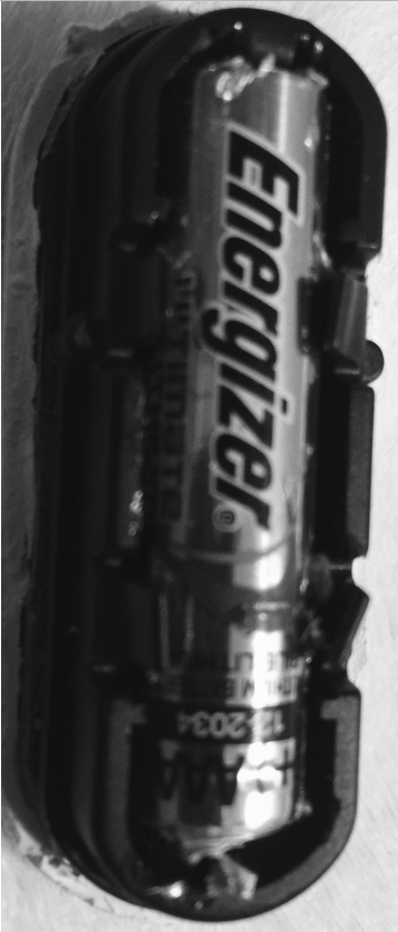

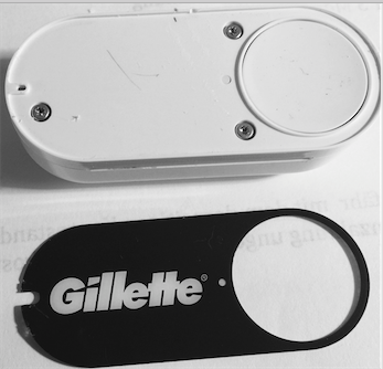

here the inside of the amazon dash button:
it has an AAA battery in the back, which could be replaced, but it is soldered in, so a bit tricky
The front can be opened after you remove the plastic film which shows the product name. after that you need to unscrew three 8x corner very small screws , Then it falls apart.
It has
one button just under the REV01
one uFL antenna connector just left of the white label
one 8 pin programming socket top right
one microphone top end
It is not clear what chips are on there as many do not have a label on them or a private label.
BUT if the battery runs out it should be possible to replace it, or just buy a new switch for $5.
It has
