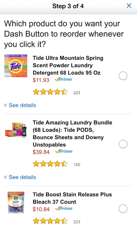

I put a USB connector next to it to show the size Setup the device :
0. start amazon app, goto menu/ your account/ dash devices- manage devices/setup a new Dash Button. Then enter your wifi password
1. press button until blue light blinks
2. position the iPhone speaker next to the dash button (yes it transmits the wifi into via sound)
stop at step 3/4 (see screen shot), click on the X
done.
After that, FINGSCAN or anything that monitors the router, network etc will pick up the device.
FINGSCAN takes ~ 1 second after button pressed and it shows device UP -- if you set FINGSCAN to the fastest frequency- at the bottom of configuration screen.
It stays up/connected for ~ 20 seconds. Then it turns itself off until you press the button again
done.
