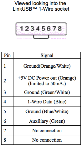

Sorry for the delayed reply. It didn't show up in the serial port list and there was actually nothing to select, but that was cause I didn't have the FTDI drivers installed. I installed the latest drivers and then there was two available things to select. I tried both of them, but it doesn't see my thermometer. Could it be my wiring is incorrect? Right now I've got my 1-wire thermometers wired up to an Arduino board and I know they work. I only connected the blue wire (Pin 4 on TIA/EIA 568B cable wiring scheme) from my LinkUSB to the 1-wire thermometer and it doesn't see it. Does your plugin require the other wires to be connected too?

They call it a 1-wire interface but it actually needs two, Ground and 1-Wire data, for it to work. The 1-wire refers to how many signal wires are required for communication, the common ground requirement is assumed. It's a little mis-leading if you're not an electronics guru.

My setup has been working fine. I have the LinkUSB connected to 2 iButtonLink T-Sense Temperature Sensor using the RJ45 jacks.
Plus 5 Dallas ds18s20 in a TO-92 package. However I am using the third wire for 5 volt power. The ds18s20 can work with 2 wires (pin 1&2)
as "Parasite Mode" but I think this requires adding a capasitor at the LinkUSB between pin 2 and 4.
Since I am running the sensors on cat5 cable I have the extra wires to pas the 5 volt power to the sensor.
Hook up pins from the LinkUSB to the ds18s20 as the following:
LinkUSB pin 1 and 5 to ds18s20 pin 1 (ground)
LinkUSB pin 2 to ds18s20 pin 3 (+5v power)
LinkUSB pin 4 to ds18s20 pin 2 (1-wire data)
Hope this helps
