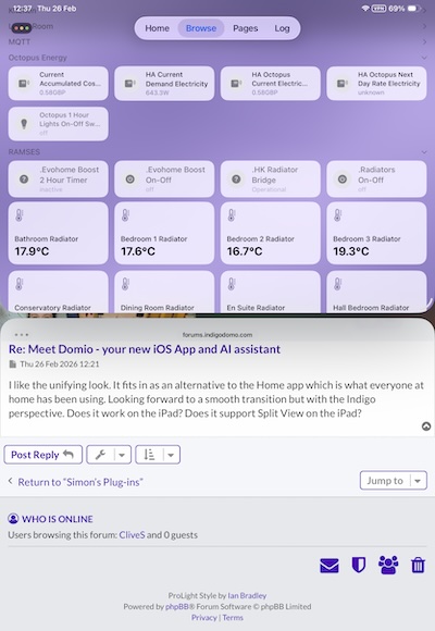

I like the unifying look. It fits in as an alternative to the Home app which is what everyone at home has been using. Looking forward to a smooth transition but with the Indigo perspective. Does it work on the iPad? Does it support Split View on the iPad?

Coolcaper wrote: Thu Feb 26, 2026 6:21 am I like the unifying look. It fits in as an alternative to the Home app which is what everyone at home has been using. Looking forward to a smooth transition but with the Indigo perspective. Does it work on the iPad? Does it support Split View on the iPad?
Yes it does.

Coolcaper wrote:I like the unifying look. It fits in as an alternative to the Home app which is what everyone at home has been using. Looking forward to a smooth transition but with the Indigo perspective. Does it work on the iPad? Does it support Split View on the iPad?
Yes. I built it to replace the Home app and remove that dependency but then to offer indigo specific items like logs and control pages and a better AI experience.
Thanks Clive for showing the Split View.

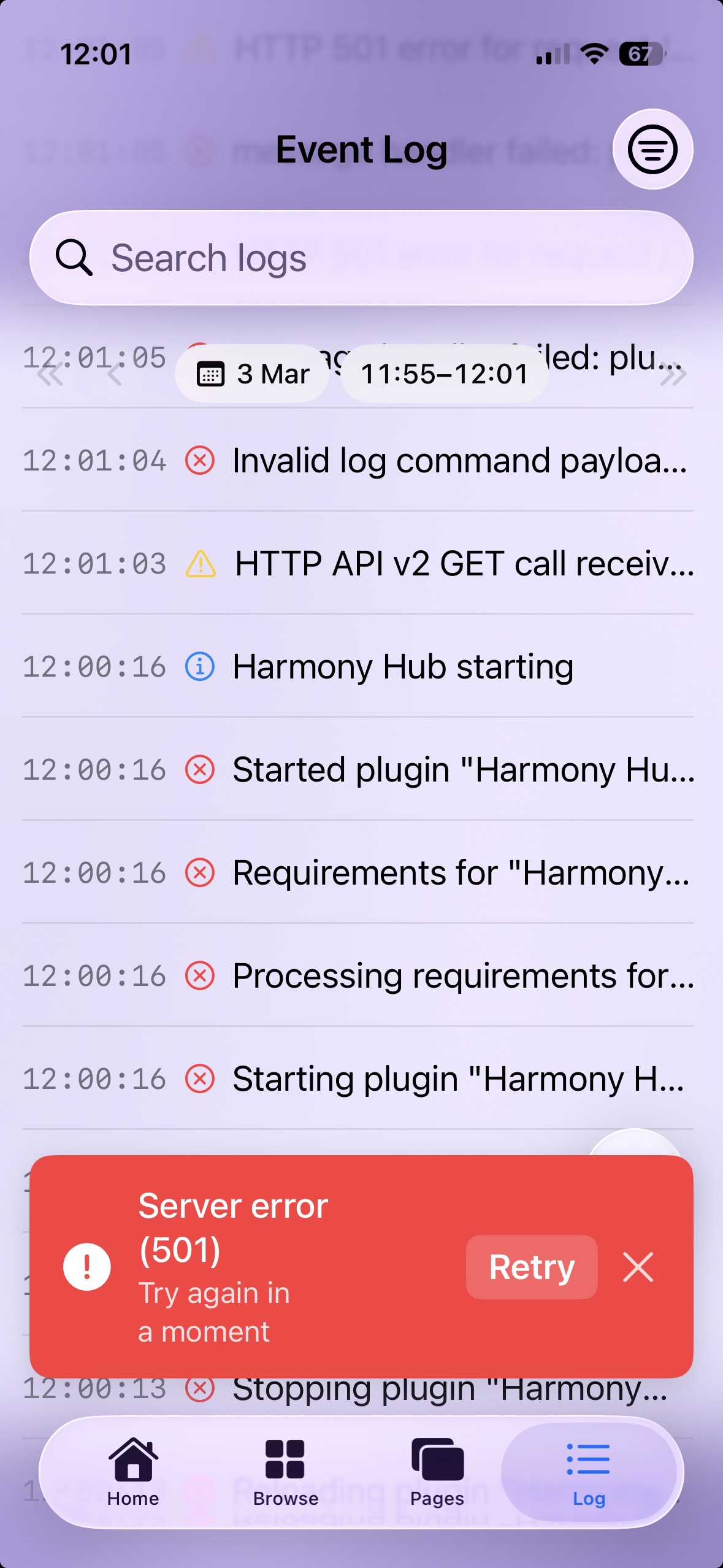

I'm getting the following errors when launching Domio on my phone. All features appear to be working ok.
I also added this to GitHub
App version: 1.1
iOS version: 26.3
Indigo server version: 2025.1
Describe the bug:The following errors are written to the log when I launch Domio
Mar 3, 2026 at 11:55:08 AM
   Web Server Warning              HTTP API v2 GET call received for indigo.devices from 173.79.109.136
   Web Server Error                Invalid log command payload received, id: '- no message id -'
   Web Server Error                message handler failed: plugin with id 'com.simons-plugins.logs-over-reflector' isn't installed
   Web Server Warning              HTTP 501 error for request /message/com.simons-plugins.logs-over-reflector/log from 173.79.109.136
   Web Server Warning              HTTP 501 error for request /message/com.simons-plugins.logs-over-reflector/dates from 173.79.109.136
   Web Server Warning              HTTP 501 error for request /message/com.simons-plugins.logs-over-reflector/sources from 173.79.109.136
   Web Server Warning              HTTP API v2 GET call received for indigo.actionGroups from 173.79.109.136
   Web Server Warning              HTTP API v2 GET call received for indigo.variables from 173.79.109.136
   Web Server Warning              HTTP API v2 GET call received for indigo.controlPages from 173.79.109.136
Steps to reproduce:
Launch Domio on the phone and go to Event logs
