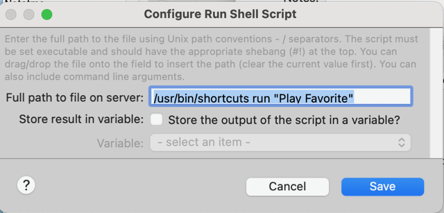

I can't seem to get my shell scripts to work and the only thing that I have changed is the version of indigo.
Does the run shell script still work - is anyone using it with indigo 24.2, Thanks
Screenshot 2025-04-02 at 11.25.27 AM.png (114.48 KiB) Viewed 462 times

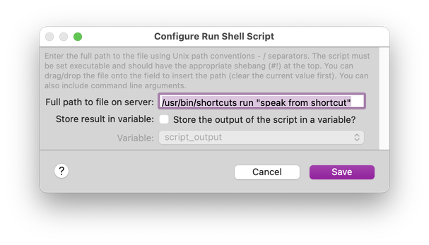

This just worked for me:
Have you run this from the command line? Sometimes, macOS will need permission to do stuff and it might prompt you to allow it so you should do "always allow" if prompted.
Also, have you tried using the Server Actions->Run Apple Shortcut action instead?
FYI, I also tried:
/usr/bin/say testing
in the Run Shell Script action and it worked as well.

Thanks - I will figure it out with your suggestions - I just did not want to spend too much time if something in the latest release broke it. Thanks again…
