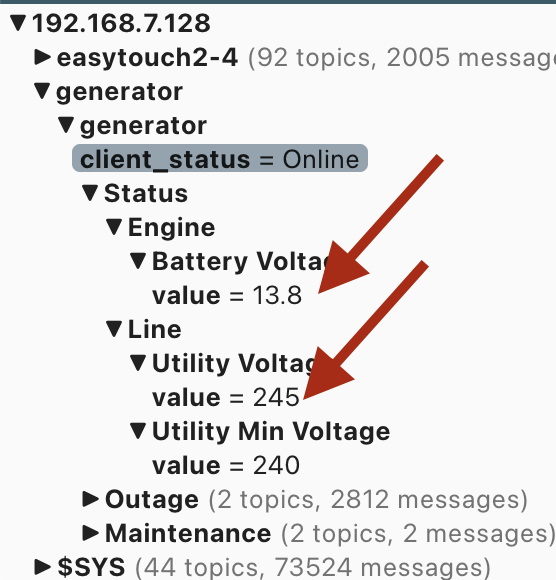

So I think I’m ALMOST, finally getting the hang of this.
Trying to connect Indigo to my generator. (see data from MTQQ Explorer below) The 2 items I’m kind of interested in for the moment are the Battery Voltage and the Utility Voltage.

BUT, when it comes to create my Shims devices, the Topic Field and the Unique ID Value are exactly the same for both items.
So my question is where to I create the difference? Do I need to create 2 Connectors, and follow thru from there? Do I need to create 2 separate Triggers with different Message Types, or is there a way to do this directly in the Shims device with some kind of ID path like "Status/Engine/Battery Voltage/value" string?

You just need to extend the topic string you’re matching on to get the specific value you’re targeting for that device.
generator/generator/Status/Engine/Battery Voltage
And
generator/generator/Status/Line/Utility Voltage
Yes, two triggers and two message types. But only one connector is needed.

Also, your second topic subscription is redundant since the first one is a wildcard.

There is a way to do it with only one trigger, but requires a lot more back end configuration and processing to pull out the separate values. In this case it’s not worth it.

So I was able to successfully get this to work with only 1 Connector.
