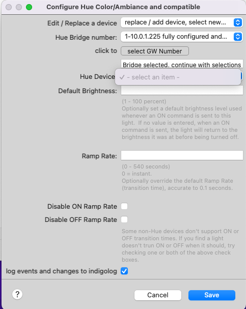

Today I added 3 new Hue bulbs to the house. They're just dimmable warm white bulbs, not color or color temperature adjustable. However, I can't add them to Indigo using the Hue Lights Plugin. When I create a new device, confirm the hub, etc., the dropdown list is empty. However, the bulbs I have added previously work fine. Am I being dumb? What am I doing wrong? Also, I don't know which model to choose for the plain warm white bulbs (they're offical Philips Hue bulbs) so I've tried all variations without success.

The plugin should automatically add new devices. You can switch that in/off in plugin configuration.

Have you already looked into the "HUE New Devices" folder?
(In the left column)
And what Karl said:
"The plugin should automatically add new devices"
You don't have to add manually a new HUE device, it works all by itself, so beautiful!

Same problem here ... I have 2 Hue bridges each with about 30 lights and a couple of switches configured. I added a sensor to Hub-2 yesterday and ws able to add that sensor device Ito my Indigo config via the Hue Lights plugin. No problems.
But the lights ... no luck and no love. I run the plugin's "add new devices" process, searching for lists and sensors and groups, and it adds zero devices.
I try adding the device "manually", but my drop-down also shows zero devices available to be added.
But here's the weird unexpected thing. If I use the plugin's "rename device" option, I can see each and every light that is know to each Hue bridge. So the plugin *knows* that these six new lights are out there, it just won't add corresponding devices into Indigo for them.
It *feels* a little like the *scan for device* process (and the populate dropdown process) are coded with an expectation of a maximum of maybe 60 devices ? I've read that this was the hard maximum per bridge, so if this plugin was ever coded to handle only a single bridge that kind of cap could be a leftover. in the code? Anyone able to check into that?

I'm having the same problem. I wonder if we are exceeding the max number of devices that the Hue plugin can accommodate.
Out of curiousity, how many Hue bridges are you running and how many devices per?

there is no limit for number of hue devices in the plugin, only max 4 bridges.
I have 80++ devices on 4 bridges.
The limits on a bridge are not physical devices, but "logical" that is much less than physical devices. That's why I need 4 bridges.
now to your question, please in config:
1. check: autocreate new hue devices. ..
2. check debug(9) find hue bridges
and restart the plugin. then send me the log file (KARL WACHS at me com)
I just tried it:
1. delete an indigo hue devices, restart and the devices gets added (with auto create devices)

Well, I’m a little embarrassed and a lot impressed.
I didn’t reslize that this plugin was executing that device. Reation process on its own. Sure enough, the devices I was looking for had already been created and were sitting in the designated folder (Hue New Devices).
So sorry to have bothered you with this. Appreciate your plugin and your patience.

I've got this problem. dropdown empty, but the Hue exterior spotlight is NOT in "hue new devices."
It IS in the Hue app, and it is in my Apple Home app. (and it responds to commands from either of these apps.)
Unsure how to further troubleshoot this.

Did you do menu add be hue devices ?

I did try the "add devices" option but I'll try it again.
   Hue Lights                      folder:"Hue New Devices" already exists, id = 1446212250
   Hue Lights Warning              autocreateNewDevices Lights  --  #of NEW Indigo devices created:0
   Hue Lights Warning              autocreateNewDevices Sensors --  #of NEW Indigo devices created:0
   Hue Lights Warning              autocreateNewDevices Groups  --  #of NEW Indigo devices created:0
Re: Device dropdown empty
Then they must already be in indigo.
Do print menu all lights
==  Bridge:1, ipNumber:192.168.1.201, hostId:99Bnrhmhq58oVOndrW-ELIQ4hfegsUBJi7ZvcMz-, paired:True, #of lights:32, sorted by:id
 ID ONoff Offln modelId--------- type--------------------- uniqueid------------------ SNumber Name------------------------------- ProductId-------------------- manufacturername------------- ProductName------------------ Group indigoDevName-----
  1   1     0   LWA011           Dimmable light            00:17:88:01:0b:27:29:5d-0b         Guest1 Stehlampe unten              Philips-LWA011-1-A60DLv6      Signify Netherlands B.V.      Hue white lamp                1,11  Hue_light_1_1_Guest1 Hue white stehlampe big
 50   1     0   929003809701_02  Extended color light      00:17:88:01:0e:56:87:70-0b         Wintergarten ceiling 3              Philips-LCG006-1-GU10ECLv3    Signify Netherlands B.V.      Hue Centura spot              83,84,87Hue_light_1_50_Wintergarten ceiling 3
 51   1     0   929003809701_03  Extended color light      00:17:88:01:0e:42:c0:be-0b         Wintergarten ceiling 4              Philips-LCG006-1-GU10ECLv3    Signify Netherlands B.V.      Hue Centura spot              83,84,87
you should see any any device that is not in indigo having an empty last column like # 51 shown here
