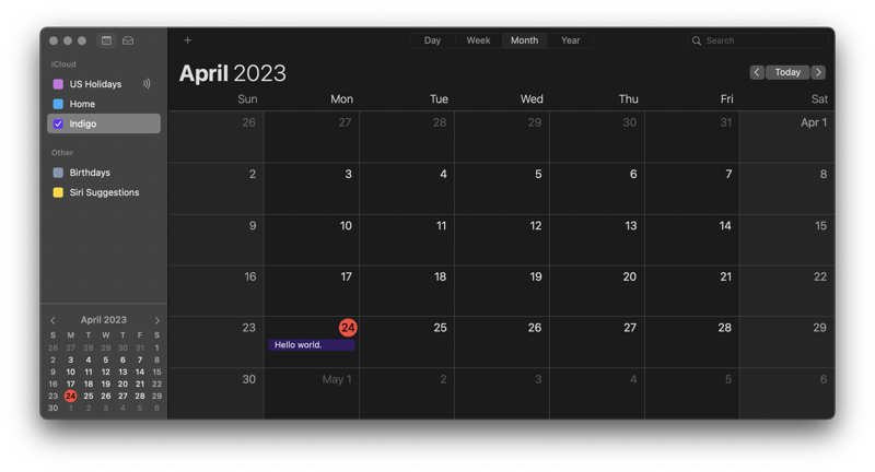

This example shows one way to create a new Calendar event from Indigo with included data. This kind of automation is probably most useful for tracking things that happen infrequently--you could easily overwhelm your calendar with something that happens multiple times per day. This is a bare minimum example that's meant to show the necessary pieces. It assumes that all the necessary pieces are set up on your Indigo server machine (access to Calendar, etc.)
You'll need three things at least:
  • Some way to cause the Shortcut to run - in this case, an embedded script that's fired using an Indigo Action.
  • An Apple Shortcut to process the incoming data and create the Calendar event.
  • An Apple Calendar to add the data to - I'd recommend a separate calendar (I've uncreatively called mine "Indigo").
Screenshot 2023-04-24 at 10.15.20 AM.png (189.65 KiB) Viewed 2455 times

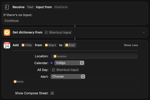

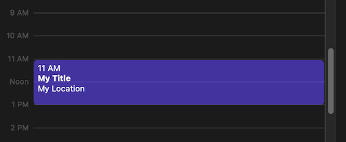

Here's an example to show how you can pass a more complex object to the shortcut.
Screenshot 2023-04-24 at 3.37.36 PM.png (18.93 KiB) Viewed 2417 times
Note the construction of the inputs (the shortcut is very particular regarding the format of the inputs). There iares likely other ways to do it.**
import os
import json
# If key 'AllDay' is set to "True" it will override the Start and End times.
# Double braces are required at the ends of the payload to ensure they're included (and not mistaken for a format specifier).
title = "My Title"
location = "My Location"
notes = "My Notes"
start = "11:00 AM"
end = "1:00 PM"
all_day = "False"  # a string
payload = f'{{"Title":"{title}", "Location":"{location}", "Notes":"{notes}", "Start":"{start}", "End":"{end}", "AllDay":"{all_day}"}}'
os.system(f'/usr/bin/shortcuts run "Post Event to Calendar" <<< \'{payload}\'')
  • A Title element is required, but the other elements are optional depending on your event data. For example, Start and End times aren't required if you create your events as "All Day" events.
  • Emoji characters are allowed in text fields (i.e., Title, Location, Notes).
  • Start and End times can be descriptive. For example, Start: "11:00 AM" and End: "Tomorrow at 1:00 PM"
