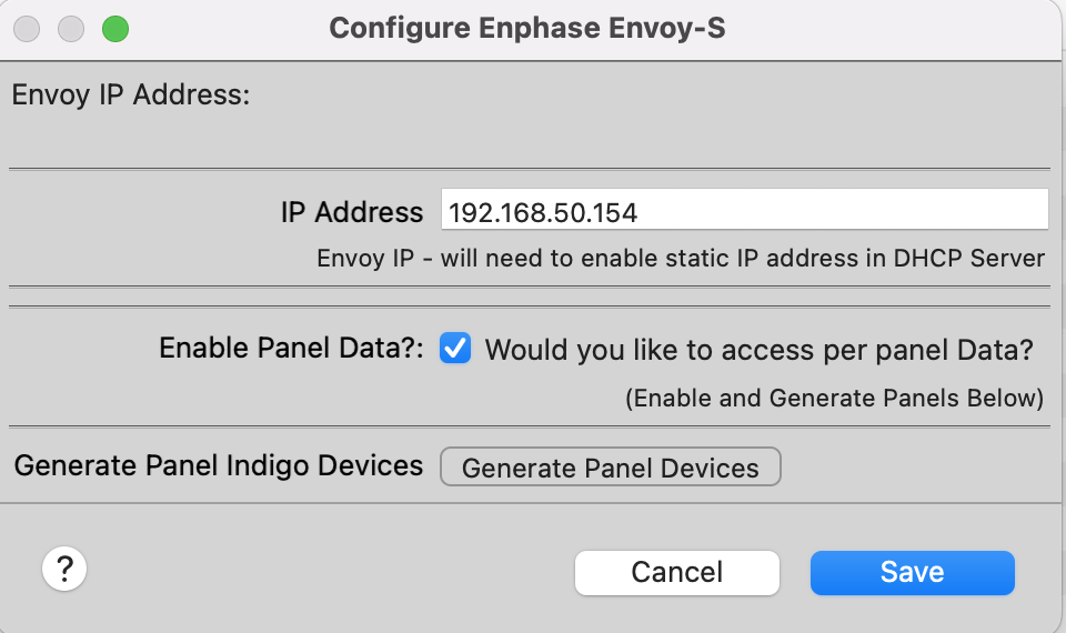

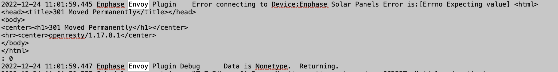

I have a new Enphase system and am trying to use this plugin. When I create an Enphase Envoy-S device it only asks for the IP address. It doesn't ask for the serial number. I attached a screenshot and error in log.
It creates the device but it is offline.
Basic question about creating a Enphase Envoy device.
- screen.png (89.63 KiB) Viewed 1786 times
- log.png (70.28 KiB) Viewed 1786 times

Hi
We no longer need the serial no as can usually be pulled from data received.
For some reason - that IP address is not returning the usual Envoy-S data:
Error 301
Either IP address is wrong
Or your device is not a Envoy-S
Or there has been some major change I am yet to see.
Glenn

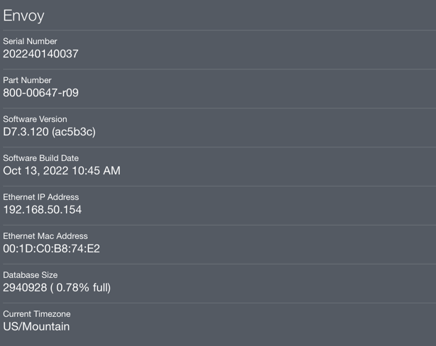

Pretty sure thats the same thing - they have just renamed it.
Go to your IP address of the device in a Browser and paste what you see…
& then try
http://Ipaddressofdevice/info.xml
Edit:
Firmware 7+ appears to be an issue. With most integrations breaking.
It needs Token authentication and most things seem locked down.
I would guess the first web-browser info above will have you on Firmware 7+
It is fixable - although needs a reasonable amount of work to add the token exchange. (token generation is with enphase online website). No ETA from me on this….

Re: Basic question about creating a Enphase Envoy device.
here it is
- Envoy.png (62.12 KiB) Viewed 1704 times
Yep.
Firmware 7 - which now needs a token authentication exchange with enphase servers to access the simple data that previously was open. I presume also that the info.xml page is also gone, hence seem to need to manual enter serialNo again.
