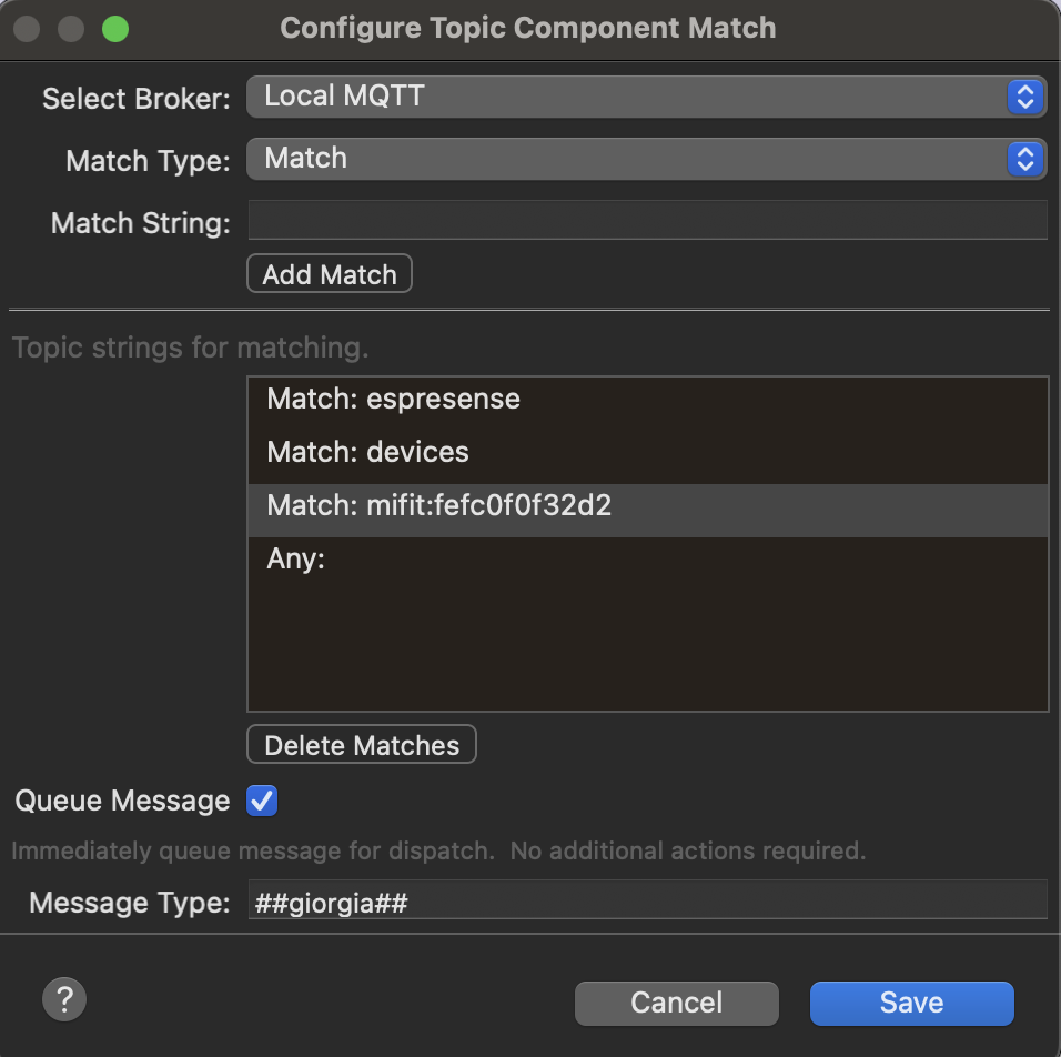

Hi all,
I do not know if this is a corner case of what, but I would like to make a match like this, and then insert the payload into a variable.
But I feel that the "column" in the last match is causing the problem, could it be the reason?

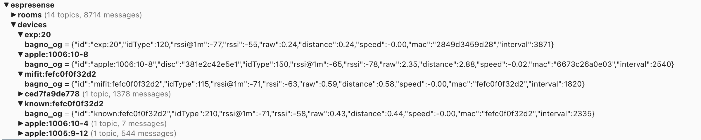

Here MQTT Explorer
and here the MQTT Connector Debug
esense Topic Received - AmazFit Giorgia: Match OK: 'devices' == 'devices'
   MQTT Connector Debug            ESPresense Topic Received - AmazFit Giorgia: match.split = 'Match' 'mifit:fefc0f0f32d2'
   MQTT Connector Debug            ESPresense Topic Received - AmazFit Giorgia: topic_part 2 = 'known:fefc0f0f32d2'
   MQTT Connector Debug            ESPresense Topic Received - AmazFit Giorgia: Match Failed: 'mifit:fefc0f0f32d2' != 'known:fefc0f0f32d2'
   MQTT Connector Debug            ESPresense Topic Received - AmazFit Giorgia: Matching complete, is_match = False
   MQTT Connector Debug            Local MQTT: Message topic: espresense/devices/known:fefc0f0f32d2/bagno_og, payload = {"id":"known:fefc0f0f32d2","idType":210,"rssi@1m":-71,"rssi":-58,"raw":0.43,"distance":0.44,"speed":-0.00,"mac":"fefc0f0f32d2","interval":2302}
   MQTT Connector Debug            Local MQTT: processReceivedMessage: espresense/devices/known:fefc0f0f32d2/bagno_og, payload: {"id":"known:fefc0f0f32d2","idType":210,"rssi@1m":-71,"rssi":-58,"raw":0.43,"distance":0.44,"speed":-0.00,"mac":"fefc0f0f32d2","interval":2302}
   MQTT Connector Debug            Local MQTT: Saved states, topic: espresense/devices/known:fefc0f0f32d2/bagno_og, payload: {"id":"known:fefc0f0f32d2","idType":210,"rssi@1m":-71,"rssi":-58,"raw":0.43,"distance":0.44,"speed":-0.00,"mac":"fefc0f0f32d2","interval":2302}
   MQTT Connector Debug            ESPresense Topic Received - Bagno OG: type = topicMatch, broker = 1038765987
   MQTT Connector Debug            ESPresense Topic Received - Bagno OG: topic_parts = ['espresense', 'devices', 'known:fefc0f0f32d2', 'bagno_og']
   MQTT Connector Debug            ESPresense Topic Received - Bagno OG: match_list = match_list : (list)
     Item : Match: espresense (string)
     Item : Match: rooms (string)
     Item : Match: bagno_og (string)
     Item : Any:  (string)
   MQTT Connector Debug            ESPresense Topic Received - AmazFit Giorgia: match_list = match_list : (list)
     Item : Match: devices (string)
     Item : Match: mifit:fefc0f0f32d2 (string)
   MQTT Connector Debug            ESPresense Topic Received - AmazFit Giorgia: match.split = 'Match' 'espresense'
   MQTT Connector Debug            ESPresense Topic Received - AmazFit Giorgia: topic_part 0 = 'espresense'
   MQTT Connector Debug            ESPresense Topic Received - AmazFit Giorgia: Match OK: 'espresense' == 'espresense'
   MQTT Connector Debug            ESPresense Topic Received - AmazFit Giorgia: match.split = 'Match' 'devices'
   MQTT Connector Debug            ESPresense Topic Received - AmazFit Giorgia: topic_part 1 = 'devices'
   MQTT Connector Debug            ESPresense Topic Received - AmazFit Giorgia: Match OK: 'devices' == 'devices'

Re: Trigger - Match String containing "column"
That looks like it should be working. Do you have (or can get) a log segment where that topic is actually received. It's not in the log segment you posted.
