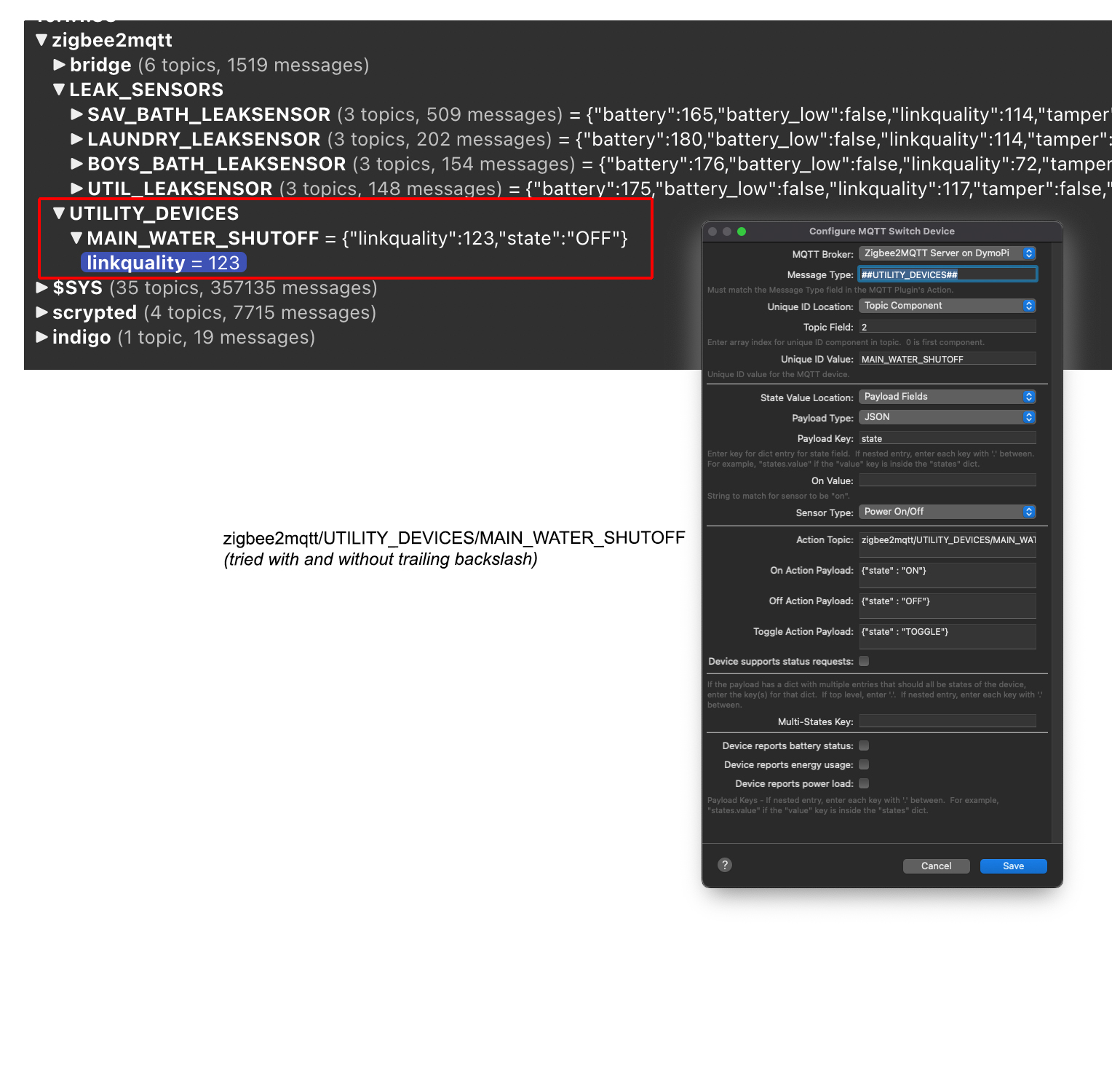

here is my setup - no problem reading the device - and I can trigger to open/close via the zigbee2mqtt app, so I know it works.. Do I need to modify any of the device/variable control settings in the broker device?
No luck based on your example..

Re: Triggering a zigbee device
Did you find your device here?
https://www.zigbee2mqtt.io/supported-devices/

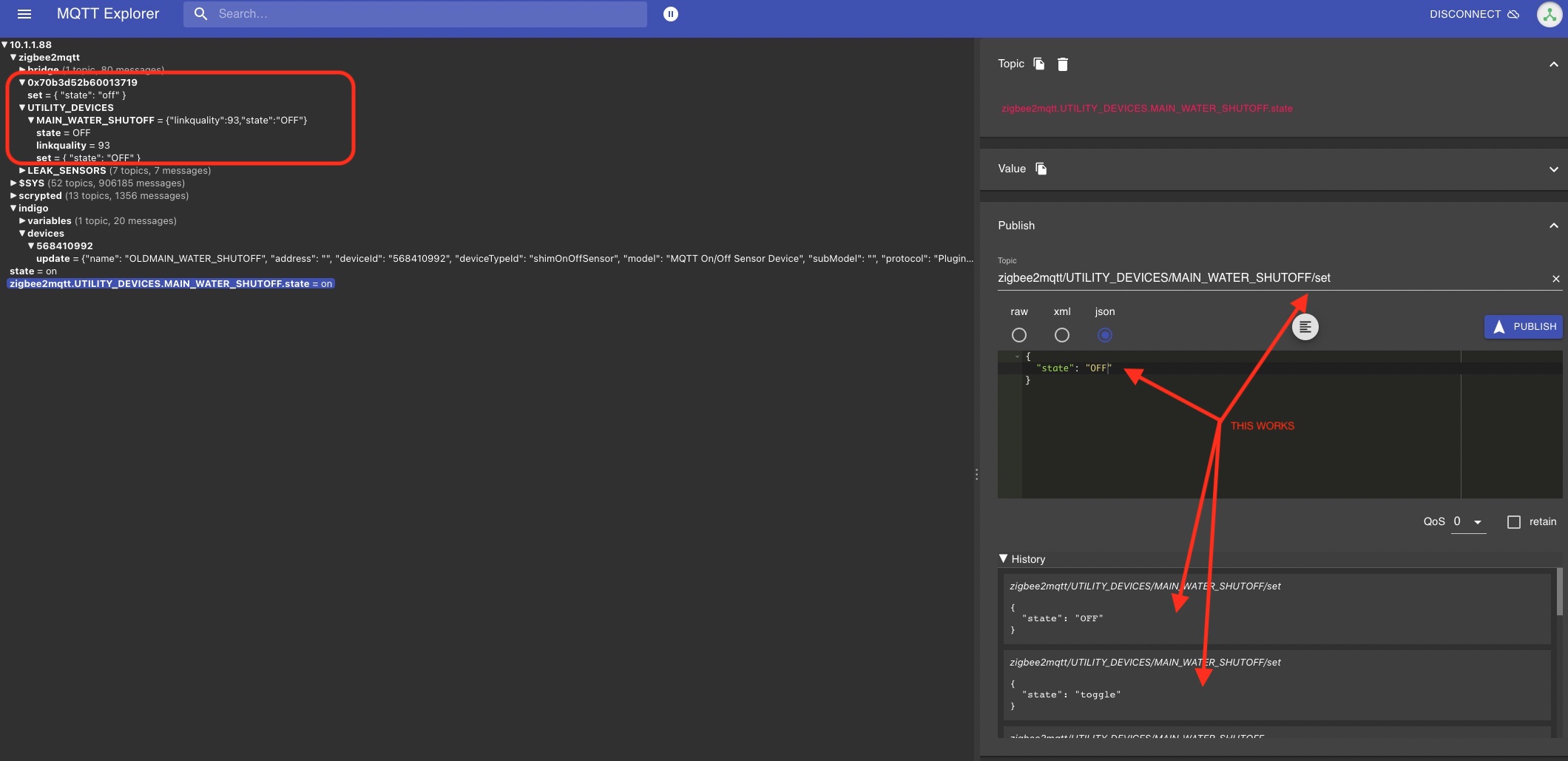

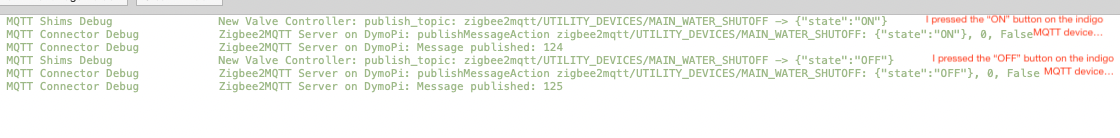

see attached screenshots - lmk if I missed anything..
re: Clear the MQTT Explorer memory
- i cleared the topic histories from the relevant devices - not sure if thats what you were looking-for...?
In order to test from indigo - i've been using the "Turn On" and "Turn Off" buttons on the device in indigo - assuming that's correct...
thanks!
thanks!
Cut and paste the log. Never do screen shots of the log.

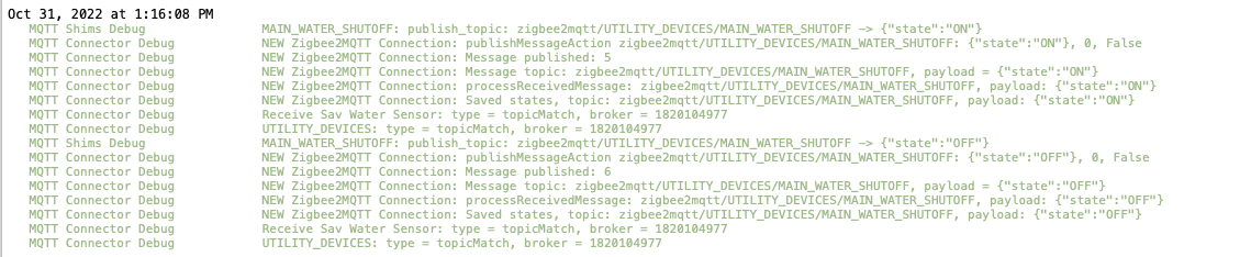

I thought you said you could control the device from the zigbee2mqtt app. I need to see the connector logs when you do that (not from the plugin). If that works.

hopefully this is what you need -
I went into zigbee2mqtt,
opened the device
went to "exposes"
clicked on on/off
here is the log from indigo:
opened the device
went to "exposes"
clicked on on/off

- Posts: 7830
Try setting up actions for the connector that has these settings:
Message topic: zigbee2mqtt/UTILITY_DEVICES/MAIN_WATER_SHUTOFF/state
payload = ON
and
payload = OFF
Do they control the device?
payload = ON
and
payload = OFF
