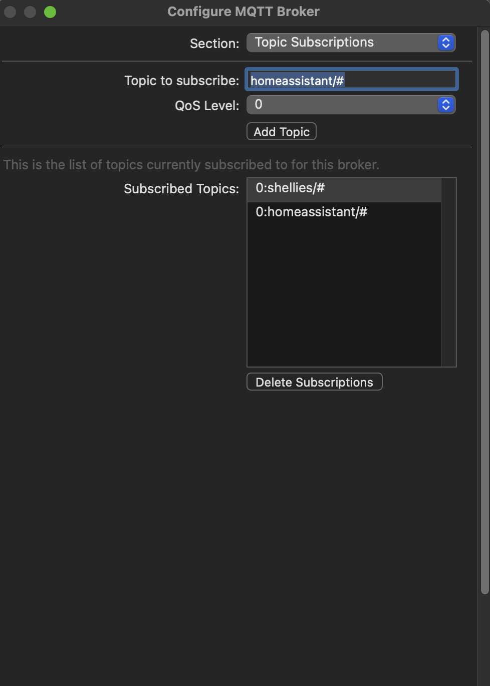

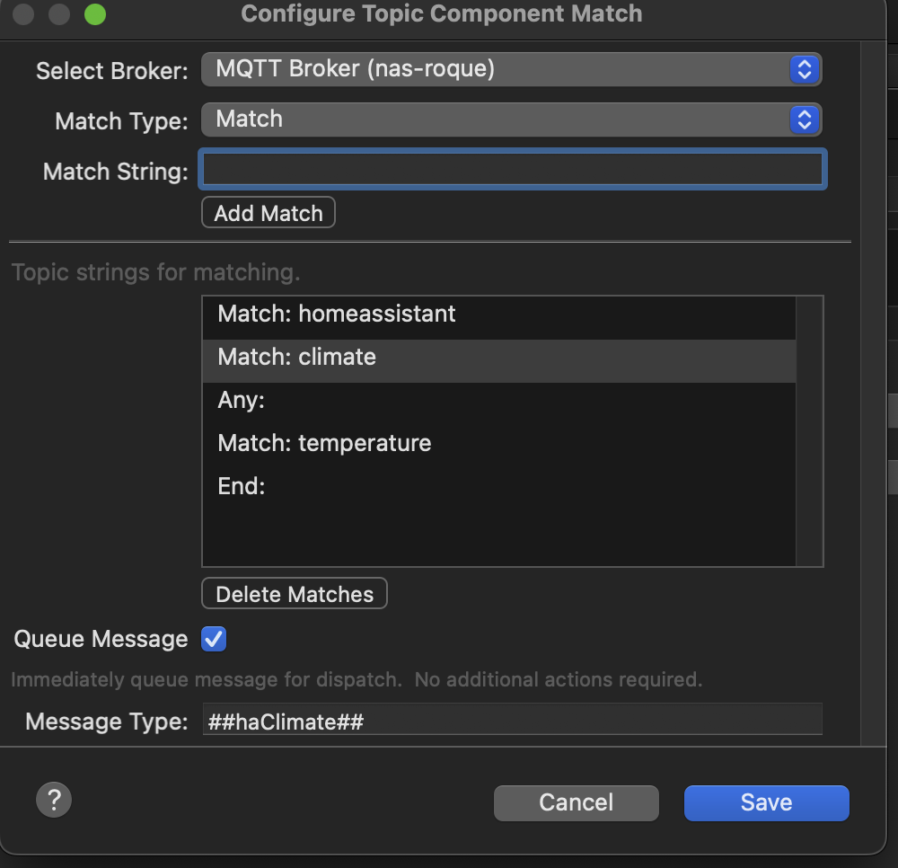

Have this configuration, that was working great before the upgrade bonanza.
Now, not getting anything in the logs, even with Shims set to "verbose debug". MQTT Connector seem to be working:
MQTT Connector Debug MQTT Broker: processReceivedMessage: homeassistant/climate/house_nativezone/temperature, payload: 76
But the trigger never gets nor shows in the log.
Ideas?
Ideas?

Ok, there's definitely something weird going on. I think it has to do with the processing of the "End" statement in the match list. That's only needed when you have topics of variable length and need to match on both the short topic and the longer topic (which contains the short topic). Such as "foo/bar" and "foo/bar/alpha" both having their own triggers.
In your case, I don't think you need it. So take it out and see if your triggers work. Meanwhile I'll see if I can figure out why it's failing, as I know it used to work.
- Posts: 7830
Re: Shims issue after upgrade
Try this pre-release with your existing triggers with the 'End' term: https://github.com/FlyingDiver/Indigo-M ... g/2022.0.3
There's got to be some subtle difference in the way exceptions are handled between the Python versions, as the plugin was using an exception to catch an end of array error to determine if the End term was correct. That worked in Py2, but failed in Py3. So I'm testing for the correct number of topic components differently now, which works in Python3.
