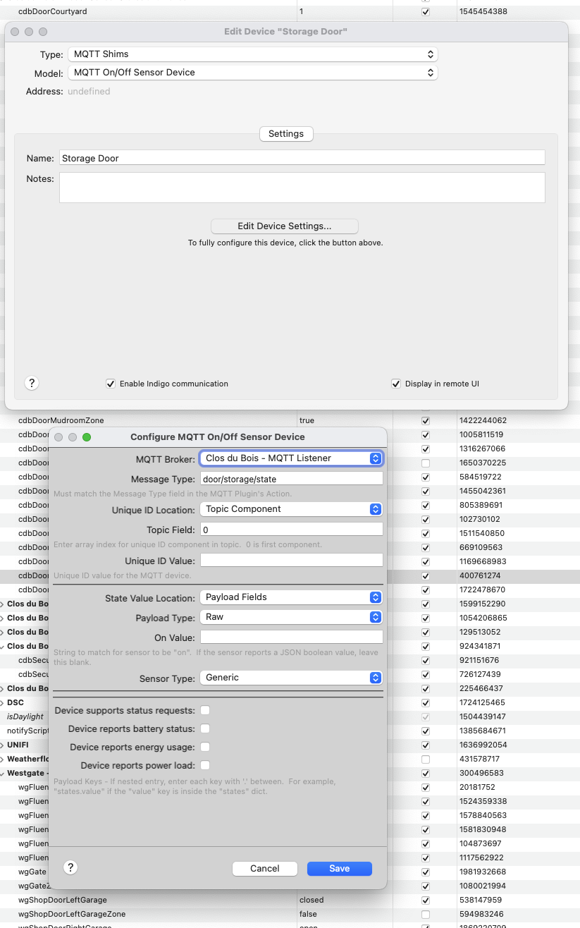

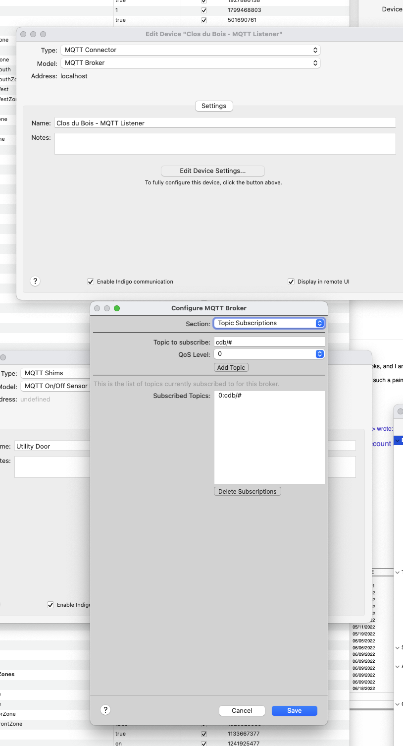

Just to be clear, this is how I have things setup right now... I have a MQTT Connector subscribed to cdb/# (not using home anymore, using cdb instead).
I also have an MQTT shim for a particular door, but am not sure how to configure that.
- Screen Shot 2022-05-23 at 1.46.07 PM.png (300.15 KiB) Viewed 3083 times
- Screen Shot 2022-05-23 at 1.45.38 PM.png (288.49 KiB) Viewed 3083 times

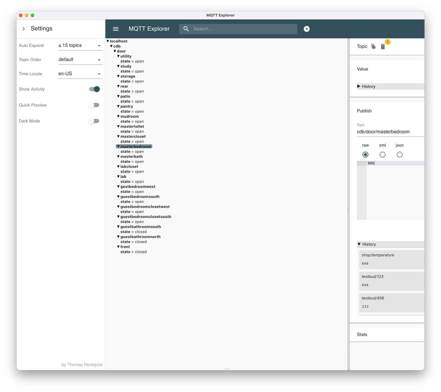

Re: Strategies for MQTT devices
And just so you know how I'm publishing, here's. a screenshot of the door states from MQTT Explorer:
- Screen Shot 2022-05-23 at 1.49.00 PM.png (277.83 KiB) Viewed 3083 times
Start with this thread post and see if it answers your questions.
viewtopic.php?f=316&t=26171#p210518
