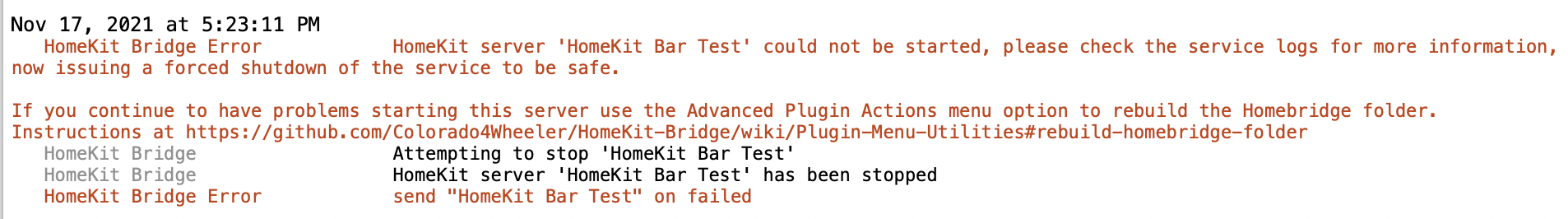

I just migrated my Intel Mini to an M1 Mini via Time Machine. I'm now finding that HomeKit Bridge will not start its servers with a message about rebuilding folders. I've tried rebuilding them with no luck. I've also tried reinstalling v1.0.2 with no luck.
(Note: the Lutron plug-in didn't work either after migration, but after reinstalling the plug-in, it worked fine. The HomeKit Bridge plug-in is prompting a Mac security warning as it's unsigned, perhaps this is the issue?)
Has anyone else seen and solved this issue?

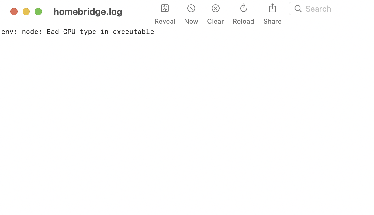

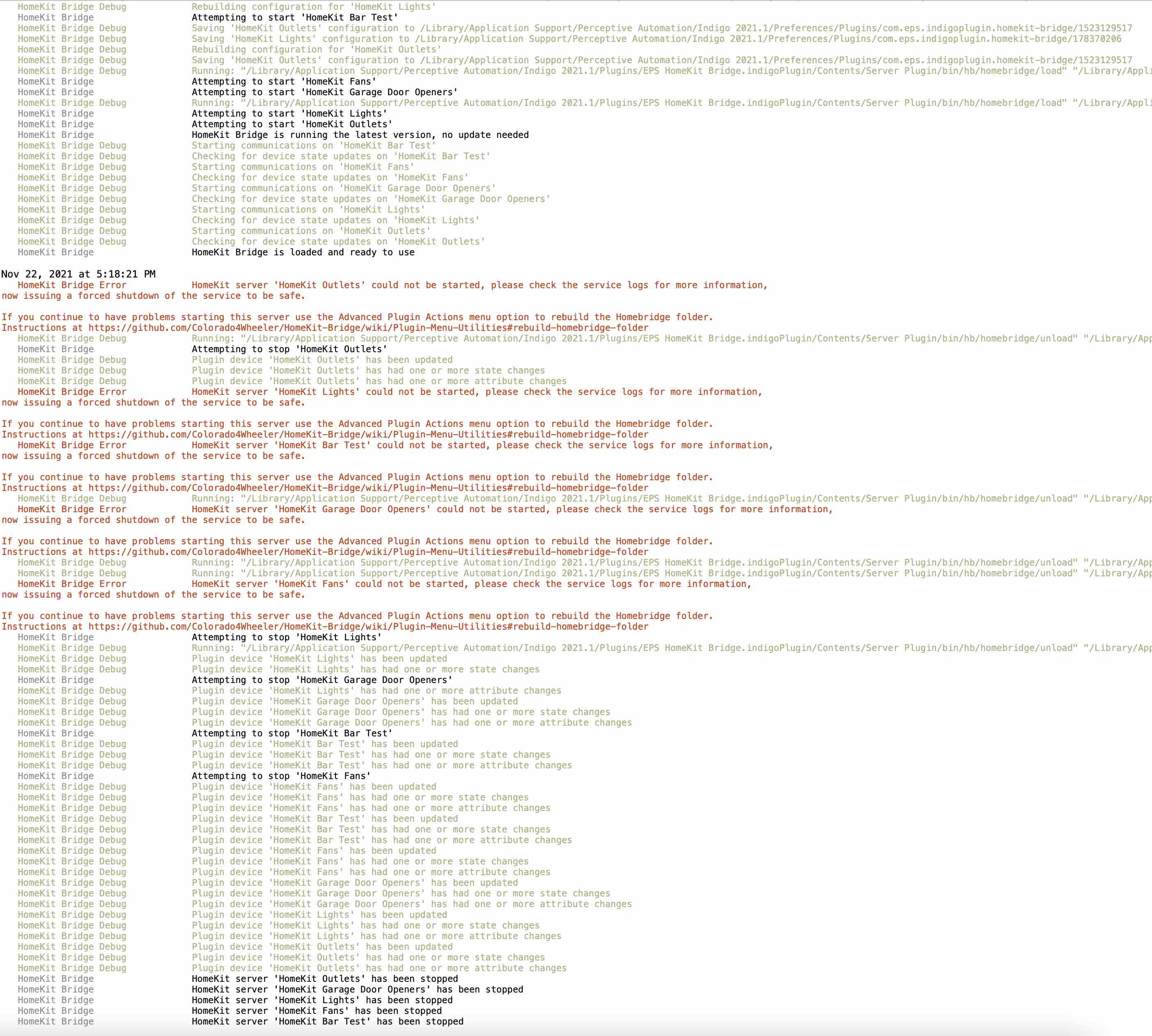

It appears similar but not the same. I've run the rebuild of the folders multiple times on each folder with no luck. I've also set the log to Thread Debug. The log is showing a bad CPU type in the executable. I'd have to guess that the plugin isn't compatible with M1 chips?
