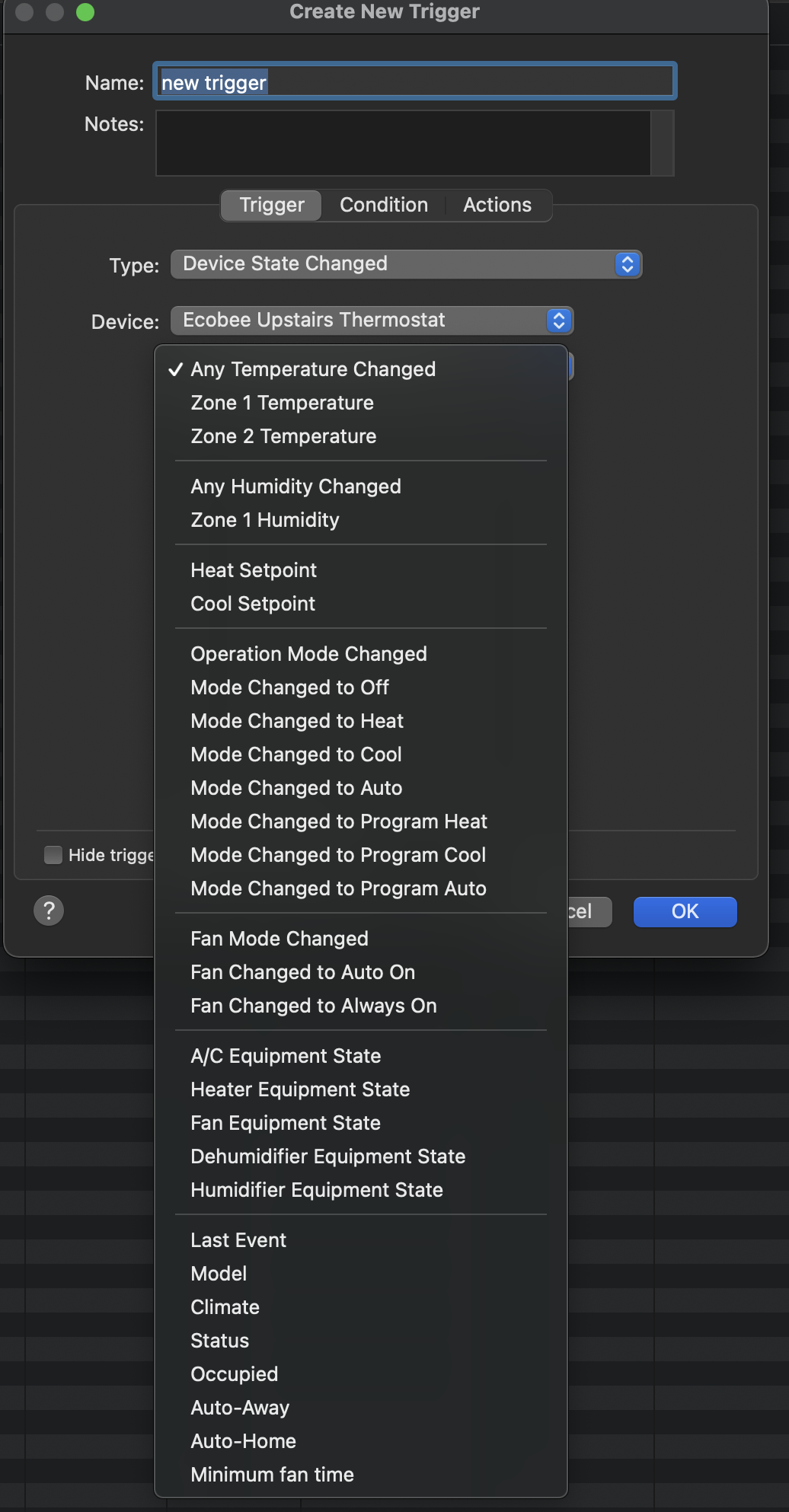

Generally easiest to look at the available states in a trigger definition. Like this:

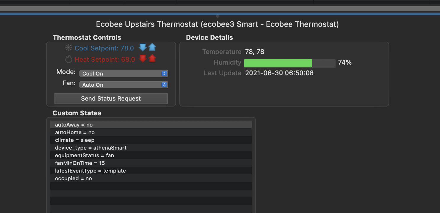

There's also some custom states:

This is perfect ! I totally skipped looking at "device state" and wrongly looked only at the "plugin" section of trigger type. This should do the trick. Thanks for your help!

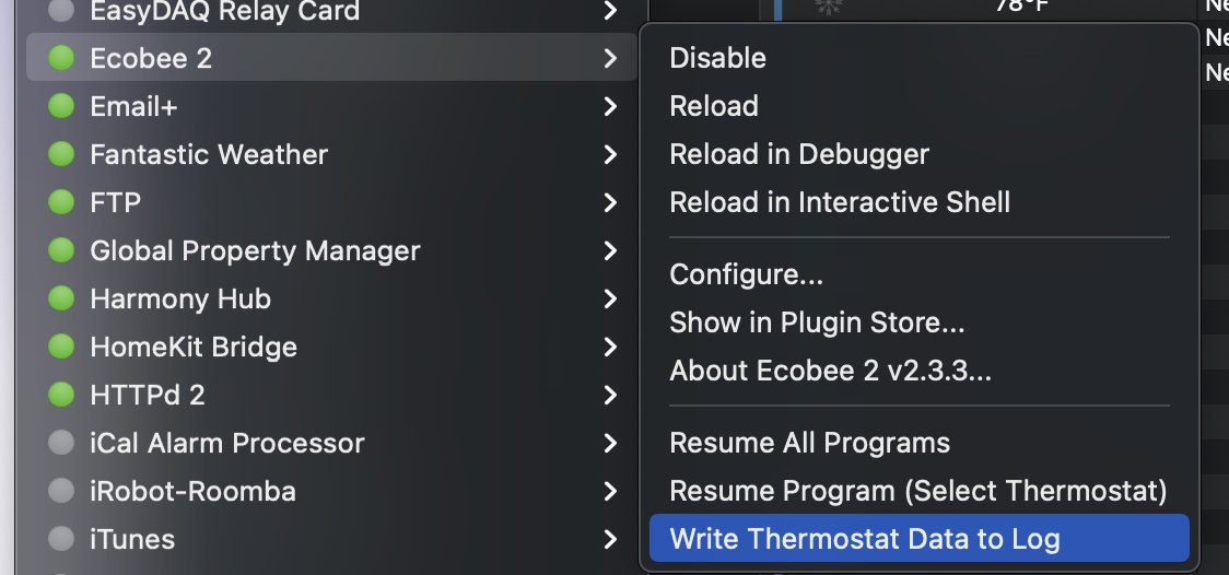

Try this: Force your unit into AUX Heat on, wait for an update, then use the "Write Thermostat Data to Log" menu command. Post that and we'll see if there's any info that's relevant.

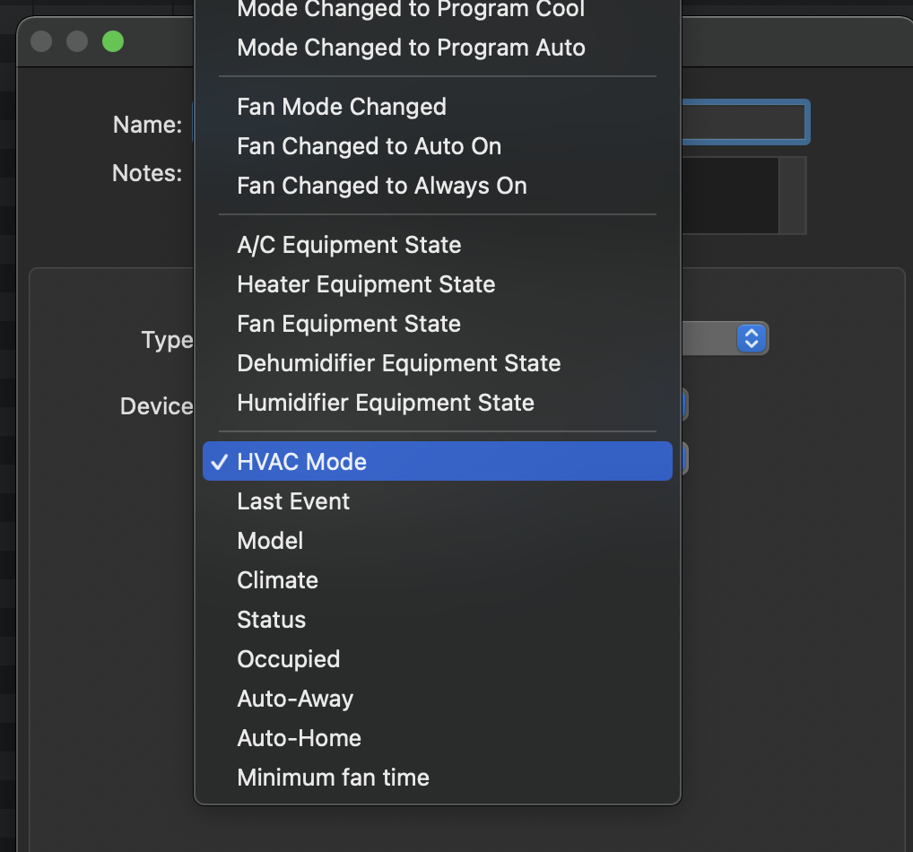

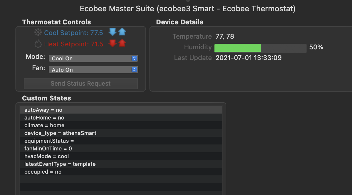

Added 'hvacMode' custom state:
Screen Shot 2021-07-01 at 1.36.58 PM.png (117.63 KiB) Viewed 4482 times
Which can be used in a trigger:
Screen Shot 2021-07-01 at 1.36.30 PM.png (331.5 KiB) Viewed 4482 times
