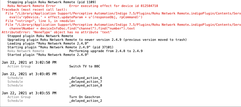

That fixed it for me, and my Action Groups to control the TV work just dandy. Thanks!
Screen Shot 2021-01-22 at 3.04.52 PM.png (90.68 KiB) Viewed 5848 times

RogueProeliator wrote:I've since replaced it, and it is available from the releases page
:D I haven't tested everything the plugin can do, but all my stuff (on/off, input) are all working and no error messages.
justlen wrote:Switch TV to BBC
Sounds like there is still something screwy going on. :lol:
