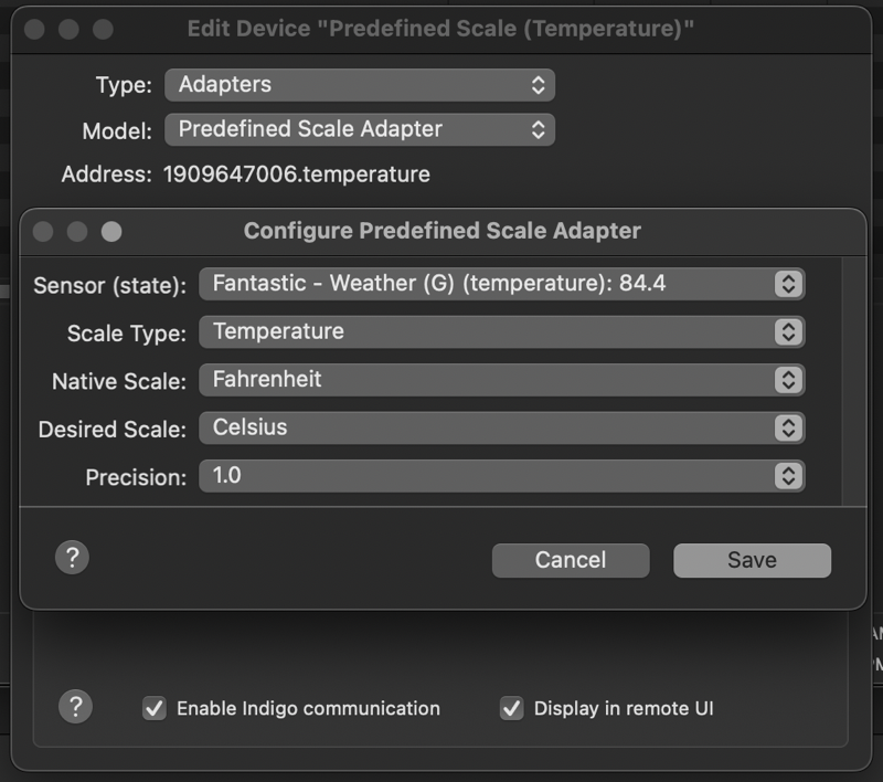

My needs are simpler than above.
I'm looking for a way to take Celsius temps and have them displayed as Fahrenheit, and to show contact sensor on/off as Open/closed.
But seriously that latter really should be a core program feature.
on the temp thing: All I can imagine doing is creating a script that turns the °C temp into °F variable values.
DaveL17
Posts: 7321
Location: Chicago, IL, USA
Re: Device Extensions continued
Post by DaveL17 »
Different Computers wrote:I'm looking for a way to take Celsius temps and have them displayed as Fahrenheit, and to show contact sensor on/off as Open/closed.
Have a look at the Adapters plugin. I've been using it pretty much since it came out (I'm also the one that updated it to Python 3). It has several built-in "Pre-defined Scale Adapters" (i.e., ºC to ºF). It doesn't have a pre-defined adapter for boolean values like on/off, but it has a Custom Formula adapter where you're only constrained by your imagination (essentially).
Screenshot 2023-10-08 at 10.45.37 AM-2.png (428.45 KiB) Viewed 11976 times

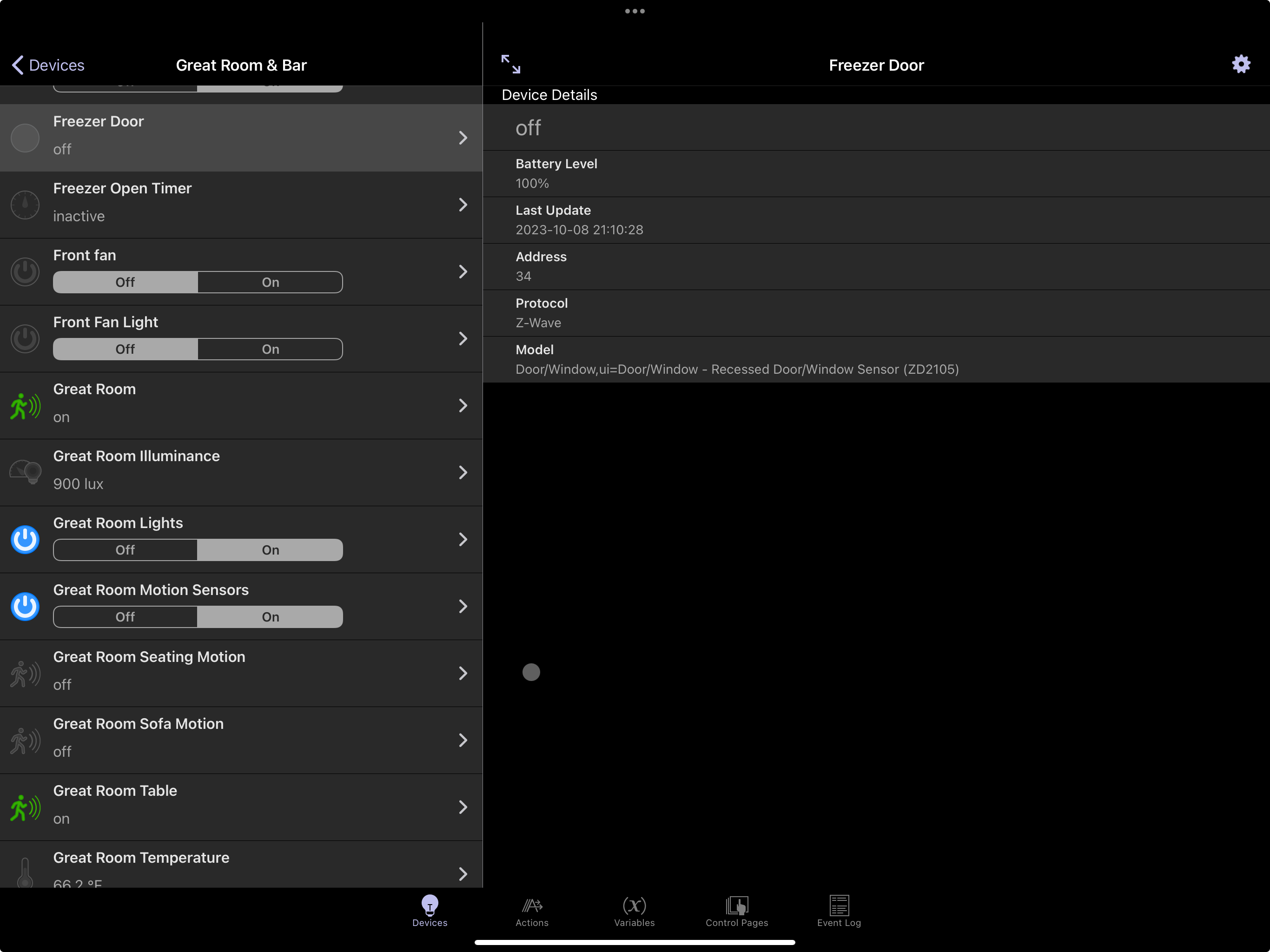

Different Computers wrote:show contact sensor on/off as Open/closed.
Show where?
Jay (Indigo Support)
Twitter | Facebook | LinkedIn
Different Computers
Posts: 2730
Location: East Coast
Post by Different Computers »
My contact sensors all show as “on/off”… pretty much everywhere.
Freezer door.png (309.9 KiB) Viewed 11919 times
jay (support)
Posts: 19232
Post by jay (support) »
We agree that a configuration option for displaying different boolean pairs is a good idea, and has been on the request list for a while. Other more significant functionality has always been higher priority.
