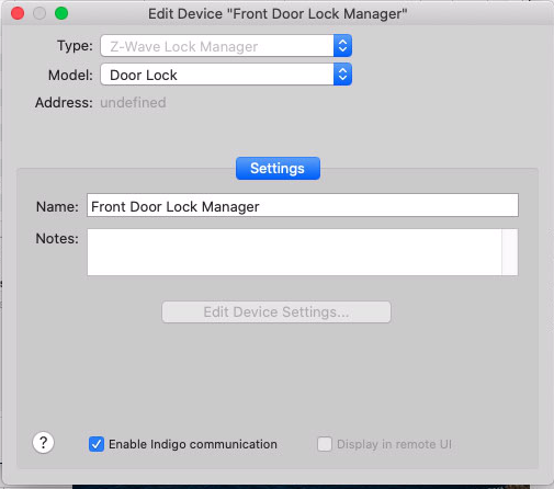

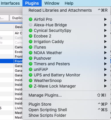

I just noticed within the past week that the Zwave Lock Manager Plugin doesn't appear accessible in any way even though its installed and enabled. Has anyone else seen this?
Stew
Stew
- plugin appears to be successfully installed and enabled
- Screen Shot 2020-07-23 at 9.20.57 AM.png (160.02 KiB) Viewed 3952 times
- Its no longer an option and is greyed out.
- Screen Shot 2020-07-23 at 9.20.38 AM.png (90.28 KiB) Viewed 3952 times

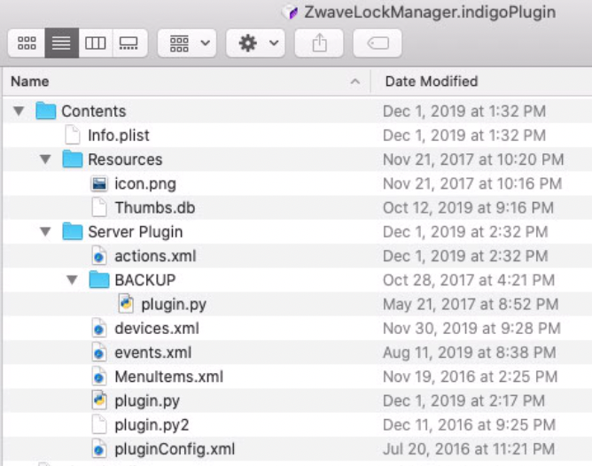

What files are in the plugin’s folder?
/Library/Application Support/Perceptive Automation/Indigo 7.4/Plugins/ZwaveLockManager.indigoPlugin
Peter
Peter
Re: Zwave Lock manager doesn't appear in plugin list
Hi Peter,
Here's the listing of the plugin contents.
Stew
Stew
- file list
- Screen Shot 2020-07-27 at 8.08.22 AM.png (409.25 KiB) Viewed 3787 times
Rename actions, devices, events and pluginConfig to Actions, Devices, Events and PluginConfig respectively.
I thought i'd fixed all my plugins to use the correct case-sensitive file names but it looks like i've not done Lock Manager.
As to why it's only just gone wrong, I can only presume an Apple OS update has only just kicked up a fuss about the case-sensitivity. It's something me and Matt have known about for a while (it rears it's head occasionally when new Indigo users discover they're using case-sensitive hard drive configuration , and i've historically used lower case names as is fairly (but not exclusively) typical in programming).
Peter

Ahh that works, thank you very much!
