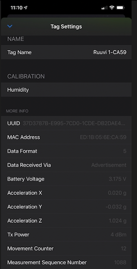

You get the MAC number of the device using the ruuvi tag station phone app.
Screen Shot 2020-05-23 at 11.11.20.png (162.86 KiB) Viewed 7951 times

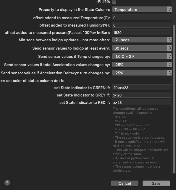

show here also the option of having a color code for the state image, here for temperature. this does not work when you show more than one state in the state column (eg temp/humidity)

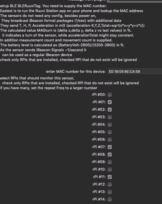

To add ibeacon type device you allow new sensors for 1 minute and pick the right one to keep: pick the right MAC number and the description field will show something like this "ruuviTag-xx:xx:xx:xx:xx-sensor" (xx:..=MAC number) (you could also just add an ibeacon device and add the mac number at the bottom of the edit screen, then you would need to to a manual push of config to the rpis, The TX- signal strength for distance calculation is ~ -63dBm (enter in the proper field in device edit)
To add the sensor device you add an indigo/pibeacon/ruuvitag device and enter the MAC number, configure some of the sensitivity parameters and which RPI should monitor the sensor, you could select all of them. Then save.
Screen Shot 2020-05-23 at 11.07.19.png (259.56 KiB) Viewed 7951 times
Screen Shot 2020-05-24 at 11.35.11.png (86.84 KiB) Viewed 7917 times

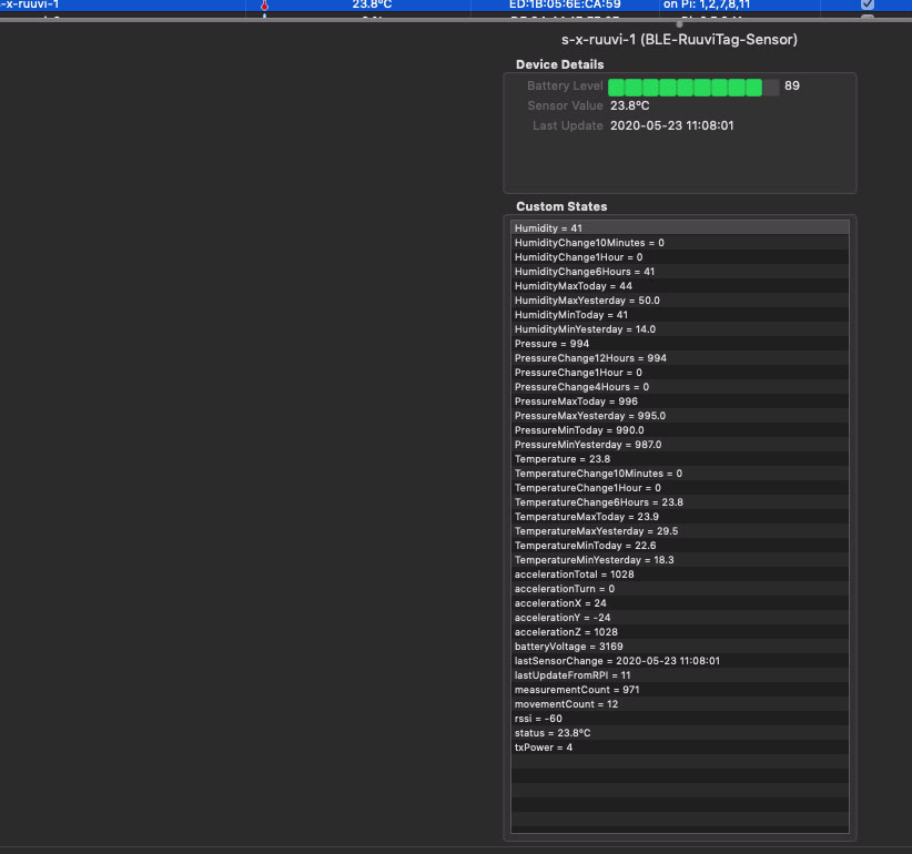

You then get the following states:
Screen Shot 2020-05-23 at 11.08.03.png (214.24 KiB) Viewed 7951 times

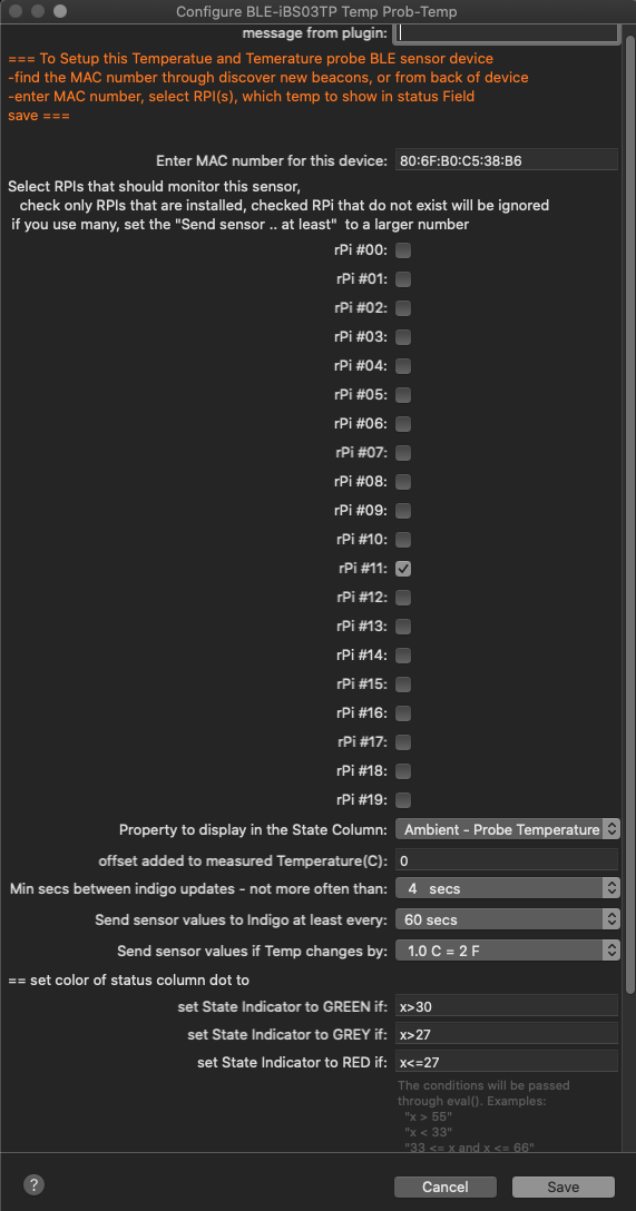

3. in piBeacon plugin: menu/accept new beacons/ select "INGISCS iBSxx", after < 40 secs you should see a new beacon. Edit it & copy mac #
4. create new device: piBeacon / model=BLE-iBS03TP .. , give it a name, paste the MAC number from #3, select closest RPI to the pool. Set other parameters: if you like red/green/grey indicator and select ambient temp to be shown in status column
== that is all for indigo.

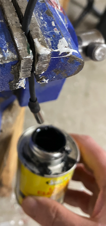

1. dump the sensor probe into liquid plastic
Screen Shot 2020-09-30 at 15.12.33.png (195.31 KiB) Viewed 7439 times
and cover the screws and the edge where it holds together

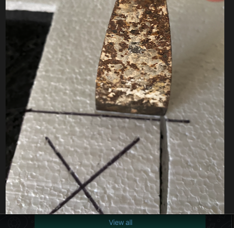

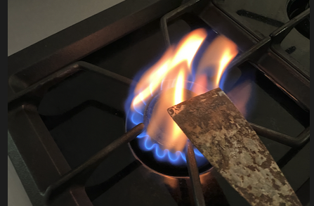

2. use a spatular, heat it
Screen Shot 2020-09-30 at 15.11.31.png (228.62 KiB) Viewed 7439 times

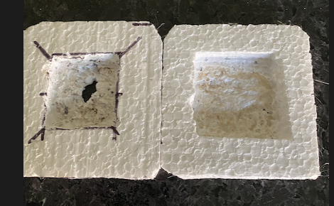

and "melt" /cut two plates of styrofoam (top and bottom) 10cmx10cm is large enough
Screen Shot 2020-09-30 at 15.12.00.png (368.25 KiB) Viewed 7439 times
3. Melt space for the sensor with the spatular in the bottom and top part. The sensor fit ~ 1/2 into the bottom part.. melt a hole into the bottom plate for the temperature probe
Screen Shot 2020-09-30 at 15.30.02.png (264.48 KiB) Viewed 7439 times

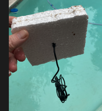

4. put everything together . You can use two small solid wires to hold top and bottom part together - poke the wires through the top and bottom plate and bend it around
5. curl up the long probe cable so that the sensor is ~ 20 -30 cm in the water.
Screen Shot 2020-09-30 at 15.28.04.png (263.57 KiB) Viewed 7439 times
6. let it swim, here shown w/o the top part
Screen Shot 2020-09-30 at 15.28.21.png (93.17 KiB) Viewed 7439 times

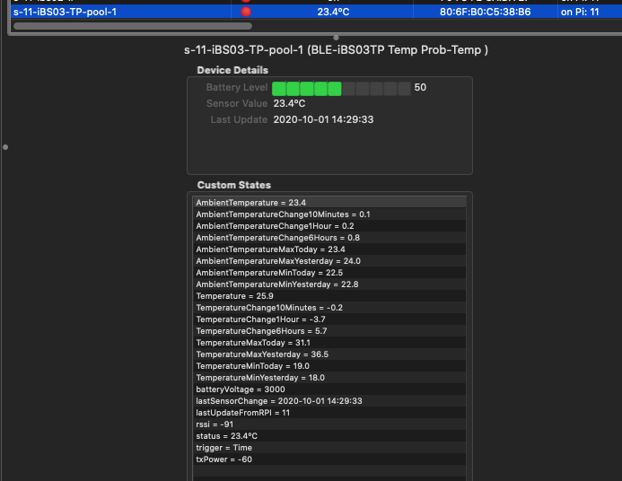

You then should see the water temperature in the device state "AmbientTemperatur" (you can set that to be the value shown in the state column in device edit) it is updated every 30 secs
You can download the android ibs01 app and set the refresh timing parameter.
The other temp value is from within the sensor. It gives you the temp just above the water line, somewhere between air and water temperature.
device edit:
Screen Shot 2020-10-01 at 19.29.41.png (129.35 KiB) Viewed 7409 times
devices states:
Screen Shot 2020-10-01 at 19.29.07.png (67.06 KiB) Viewed 7409 times
I have compared it to the old rfxcom pool temp device and the temp values where < 0.2 C apart
