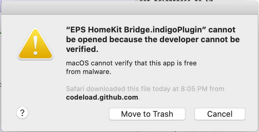

I'm getting this error after switching over to a newer Mac Mini. Everything else in Indigo seems to be working.
- Screen Shot 2020-05-01 at 8.09.59 PM.png (84.8 KiB) Viewed 7608 times

Cancel and open System Preferences -->Security & Privacy--> General.
On the bottom of this window is a section named "Allow apps downloaded from:" There will be a message asking you to Allow this extension, but you will need to unlock the Pref first.
