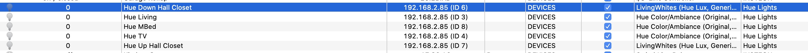

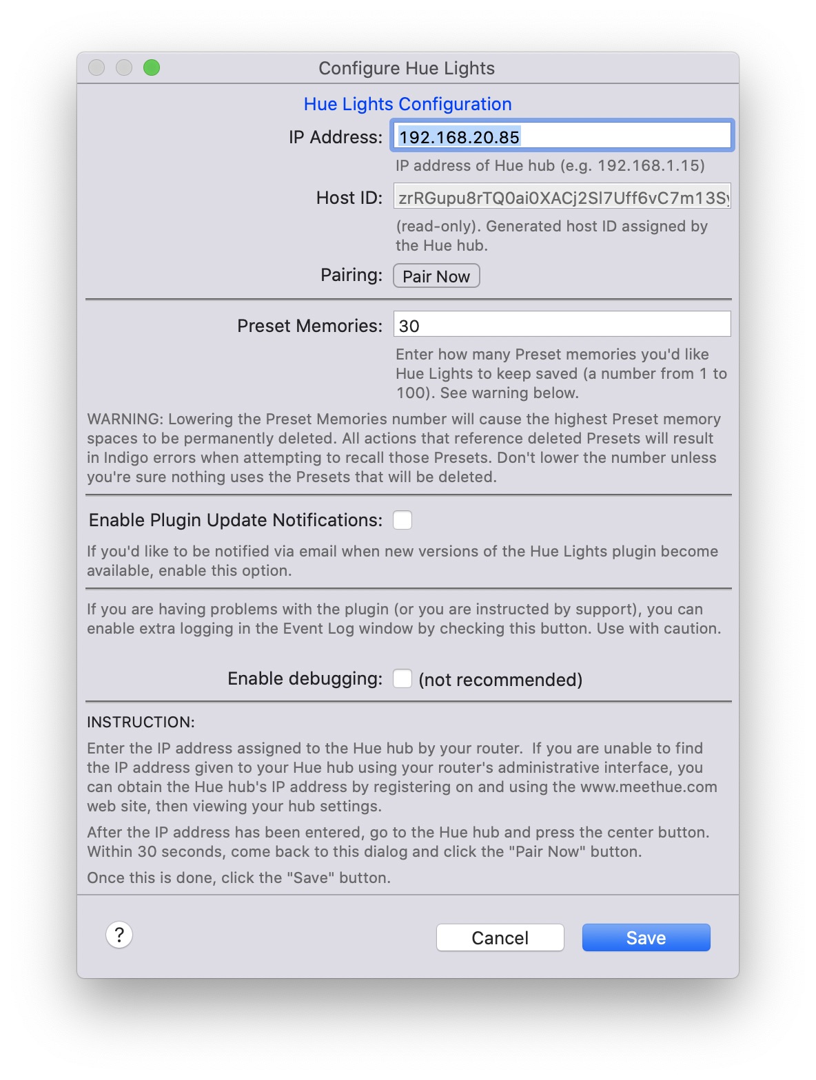

I had to change the IP address of the Hub and changed that in the plugin configuration.
Old = 192.168.2.85
New = 192.168.20.85
Even though I can turn bulbs on and off fine, in the Indigo UI, each bulb still shows the old IP. See attached screenshots.
I rebooted the entire computer, as well as selected "Reload Hue Hub Config", but still showing the same.
I don't want to delete and re-add each device, since there are so many triggers, groups, and schedules that reference them.
Although this could be a cosmetic/UI issue, it sure pushes my OCD buttons...

Hi Chris.
Thanks for the report. The Address field is strictly a reference for users and doesn't actually affect operation (as you've noticed). That said, if we're going to have a reference in the Address field, it should be meaningful. I'll work on getting that corrected in a future version of the Hue Lights plugin. For now, though, you can either ignore the incorrect address, or re-define the device (by double-clicking it in Indigo, selecting a different Type from the pop-up menu then re-selecting Hue Lights as the Type and selecting the correct Model from the Model pop-up menu).
