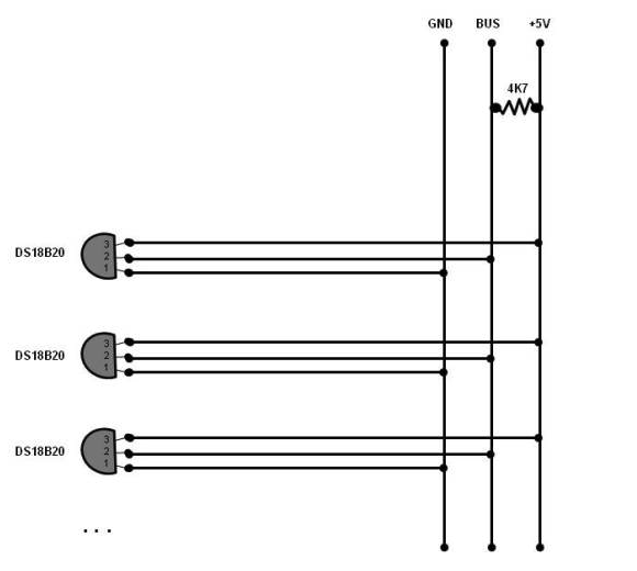

2 sections:
1. hardware setup
2. software
hardware:
- you should only use one resistor
- the cables should not be too long when using LONG cable you need to use 2 cables for the signal wire: one to and one back. it should be a star config all wires go back to the central point
DO NOT use twisted pair for signal& V+ you could do twisted pair signal&Ground and V+&ground
also if you have multiple sensor lowering the resistor value might help.
check out this site:https://www.raspberrypi.org/forums/view ... p?t=167896 for the cabling discussion
