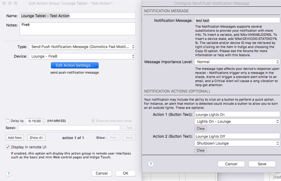

2. Send Notification - with button actions
Domotics Pad Mobile Client Threaddebug Call to validate action: sendPushNotification
   Action Group                    Lounge Tablet - Test Action
   Domotics Pad Mobile Client Threaddebug Queuing push notification command for 97002777
   Domotics Pad Mobile Client Threaddebug Plugin Command queue has 1 command(s) waiting
   Domotics Pad Mobile Client Threaddebug Push Notification Send Command: DevicePairID=s8KAAQcpoouubzmbanZ4; Type=normal; Message=test test
   Domotics Pad Mobile Client Threaddebug Push Notification Send Action 1: Lounge Lights On => 376660060
   Domotics Pad Mobile Client Threaddebug Push Notification Send Action 2: Lounge Lights Off => 546891607
   Domotics Pad Mobile Client Threaddebug Push Notification Payload=action2Name=Lounge+Lights+Off&action2Group=546891607&notificationType=ActionAlert&priority=normal&action1Group=376660060&action1Name=Lounge+Lights+On&devicePairingId=s8KAAQcpoouubzmbanZ4&message=test+test
   Domotics Pad Mobile Client Threaddebug Push notification Response: [204]
   Domotics Pad Mobile Client DebugPush notification sent successfully
This is probably because I don't understand how this should operate/does Fire Tablet Support - i.e. I'll keep playing with it, but in the tests I have done Notifications sometimes just don't get through or have a very significant delay (5 or more mins) also when two buttons are shown in the notification only the second one performs the action even if you press the 1st .
Indigo - Domopad - Notification.jpeg (183.1 KiB) Viewed 7687 times
Not an issue at all and most probably user error :-)
I just did a few tests and the second action button does seem to execute the push notification action... but I don't have a Fire setup to test this on, doing this on a standard Android device (well, tested two of them just to be sure). I'll see if I can commandeer my son's Fire and test it there. :-) In theory, though, it should work the same. Is there anything in the Indigo logs that indicates that the action group attempted to execute and failed maybe?

So I've actually been having what I believe to be the exact same issue as this myself, also with a current gen fire 8 tablet. Do you have any time estimates on v2 appearing? (Also even with these issues it's a wonderful app you've created.. it's what I wish M&J had time to do with Indigo touch on iOS.. I've bought the ultimate version of the app to show my appreciation for you efforts :D ).
