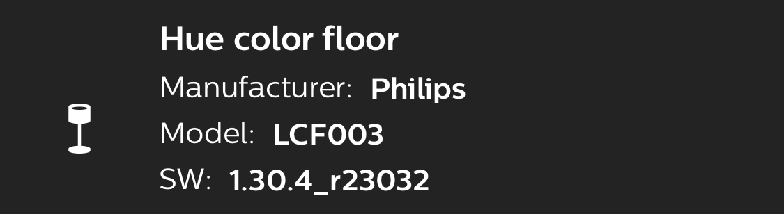

If it's not listed in the Supported Devices of the Hue API yet, then the plugin won't support it, but I can add support after you've paired it with your Hue bridge and provided me with the model ID shown for it in the Hue app.

Below our homework :D

Great! Thanks. I’ll work on adding support and let you know when it’s ready.

Version 1.7.3 Posted
  • Added support for the Hue Signe Floor light.
  • Added button hold states for the Run Less Wire switch device. Note that this feature is still experimental.
  • Fixed issue where Run Less Wire switch button ON states may not be saved.
