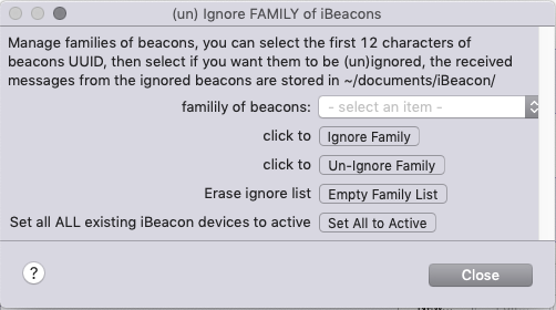

I hade new TrackR devices and tried those and they are working, yay. However my previous ones do not and I assume this is because the UUID ended up in the ignore list. I do not know the UUID of these, how do you you have it find all devices again and remove what the system ignored previously.
Thank you
Re: Had TrackR beacons working, no longer showing as closest
In menu un- ignore ...
erase ignore list to be specific
Screen Shot 2019-01-23 at 09.23.53.png (46.28 KiB) Viewed 3390 times
