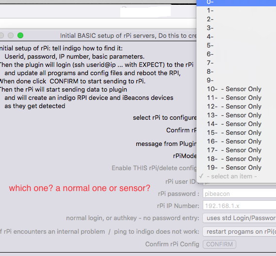

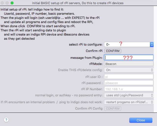

5. now I'm stuck at the initial setup, where I have to select a Pi, not shown there with the ip-adress.
What do I have to select? 0? or Only sensor? Nothing is shown, as far as I know, it should show it, or I have to specify it

1. select the rpi# ( eg 0 )
2. click on confirm (first)
3. enter the params
- ip, id, password ...
4. click on confirm (second)
then rpi0 should come back with all field populated.
as for sensor / beacon, that depend on which one you like to use. sensor does NOT have ibeacon support. only RPI 0-9 have that. that is due to the fact that the states in the ibeacon and RPI devices are static ie distance _0 .. distance_9, other wise there would be 6 times more states for each additional RPi (distance_11.. signal_11,....etc)
as for msg from plugin: there you will se OK or error .... once you click on confirm
hope that helps

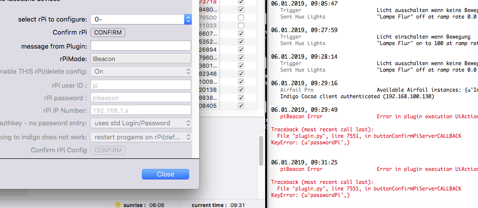

But as I click on "Confirm" an error message appears in the log, so I am not able to enter the rest.
Which password is here used?

Re: Not able to set up a new Pi
questions:
1. which version?
2. could you send ~/documents/indigo/pibeacon/RPIconfig an email to karlwachs at me com -- it contains your rpi userid and passwords , don't post

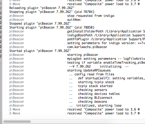

the plugin has the version number 7.99.262. downloaded yesterday.

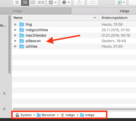

But unfortunately, I don't have the piBeacon folder under ~/documents/indigo/pibeacon/ but under ~/indigo/pibeacon/, see screenshot here.
Thanks!

Ok, thanks to Karl, I was able to get it working.
Had to delete the RPIconf file, then restart plugin.
