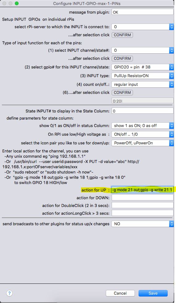

I would like an input (pushbutton) in Raspberry Pi to toggle an output each time input becomes high. How do you get that feature?
I would also like the output to show status (ON or OFF) in Indigo state at that time of operation. Is it possible?
Of course, you can create this via a trigger in Indigo, but I would like the feature to be in RBpi.
Thanks in advance!
/Sam

Re: Input toggles output in Raspberry
the string for the GPIO should work as you show it..
I guess you want to have the indigo device/state status to show ON/Off the the output gpio? .. the is not implemented as you circumvent the indigo part..
But you could use the GPIO in for that?
just a question.. how do you set it to OFF? with the down button, or another button?
Sorry,
What i meant was... i want the same pushbutton (normally open) connected to the input, to change the status of the output by an pulse on the input. The first pulse - sets the output to 1, the next pulse sets the output to 0 etc, if possible?
/Sam
/Sam
this should set gpio18 to 1 if current 0 and to 0 if currently 1 == toggle
if (gpio -g read 18 | grep 1 ); then gpio -g write 18 0; else gpio -g write 18 1 ; fiRe: Input toggles output in Raspberry
