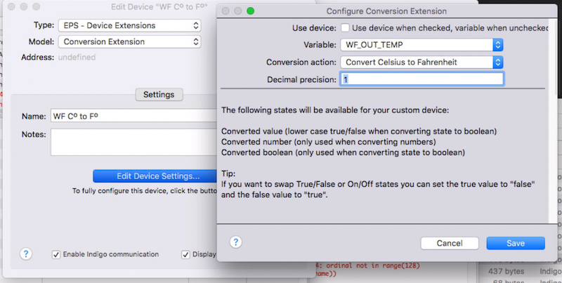

I'm getting a similar error as well:
Just 1 device trying to convert ºC to ºF
I have tried a device and a variable, and trashing the plugin prefs.

   EPS - Device Extensions Error   Exception in plug.formFieldChanged line 1179: 'ascii' codec can't encode character u'\xba' in position 4: ordinal not in range(128)
							 CODE: self.logger.debug ("Plugin device '{0}' configuration field changed".format(indigo.devices[devId].name))
   EPS - Device Extensions Error   Exception in plug.validateDeviceConfigUi line 560: 'ascii' codec can't encode character u'\xba' in position 4: ordinal not in range(128)
							 CODE: self.logger.threaddebug ("Validating configuration on '{0}'".format(dev.name))
   EPS - Device Extensions Error   Exception in plug.closedDeviceConfigUi line 602: 'ascii' codec can't encode character u'\xba' in position 4: ordinal not in range(128)
							 CODE: self.logger.threaddebug ("Plugin device '{0}' configuration dialog closed".format(dev.name))
Mar 20, 2019, 7:44:58 AM
   Reloading plugin "EPS - Device Extensions 2.0.4"
   Stopping plugin "EPS - Device Extensions 2.0.4" (pid 53964)
   EPS - Device Extensions Error   Exception in plug.deviceStopComm line 513: 'ascii' codec can't encode character u'\xba' in position 4: ordinal not in range(128)
							 CODE: self.logger.threaddebug ("Plugin device '{0}' stopped communication".format(dev.name))
   Stopped plugin "EPS - Device Extensions 2.0.4"
   Starting plugin "EPS - Device Extensions 2.0.4" (pid 54363)
   Started plugin "EPS - Device Extensions 2.0.4"
   EPS - Device Extensions Warning Upgrading plugin from version 1.53 or earlier
   EPS - Device Extensions Error   Exception in plug.deviceStartComm line 275: 'ascii' codec can't encode character u'\xba' in position 4: ordinal not in range(128)
							 CODE: self.logger.threaddebug ("Starting communications on '{0}'".format(dev.name))
Screen Shot 2019-03-20 at 10.50.16 AM.png (432.08 KiB) Viewed 3815 times
