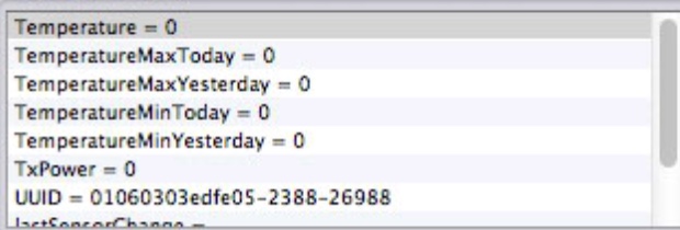

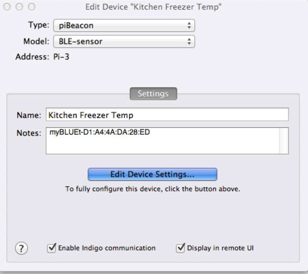

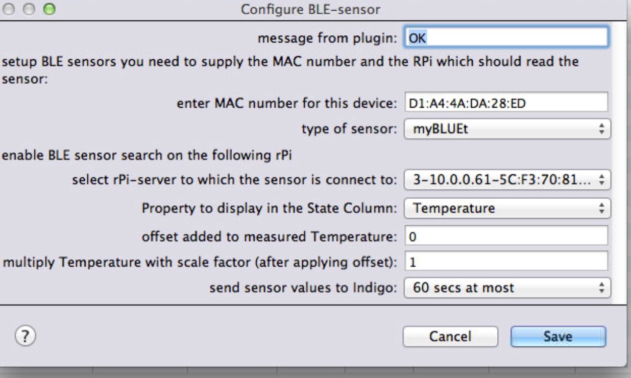

I have Four Raspberry pi setup with pibeacon, and I am trying to add a ble temp sensor.
I have a MYBlue T ble temp sensor and I am having trouble getting it to send back any temp data .
It shows the beacon Mac address and that always updates
but when I edited to add ble sensor it won't update
not sure what logs to add
thanks
temp 3.jpeg (209.04 KiB) Viewed 2428 times
temp 2.jpeg (112.39 KiB) Viewed 2428 times
temp 1.jpeg (38.65 KiB) Viewed 2428 times

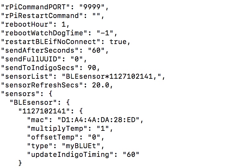

A.) check if on RPI
~/parameters has entries for BLEsensor .. something like this:
  "sensors": {
    "BLEsensor": {
      "862350368": {
        "mac": "C5:7D:B7:58:B4:22",
        "multTemp": "1",
        "multiplyTemp": "1.",
        "offsetTemp": "0.",
        "type": "myBLUEt",
        "updateIndigoTiming": "0"
if yes .. I need to dig deeper

are you sure the MAC tuber is correct? they only show the first 4 and last 4 letters..
use the BLEscan tool on the rpi to figure out the MAC #

Here is the section from the pi ~/pibeacon/parameters
Does that sensor send more than one Mac address?
I'm fairly new to this
thanks
Bob
Re: Ble Temp Sensor
parameter file looks good

just how did you get the mac number? .. it shows it backwards in the phone scanning tools
in menu you can select BLE report .. that will do most of the scanning for you and print a report to the indigo logfile .. (it will need to reboot the RPI after the scan)
Re: Ble Temp Sensor
this will do the scanning on the RPi (thats what the menu option does):
sudo hciconfig hci0 down; sudo hciconfig hci0 up ; sudo timeout -s SIGINT 100s hcitool lescan
then find your reverse BLEsensor MAC# (first 2 and last 2 digits) and copy the WHOLE number to the indigo device

I did have an incorrect Mac address,
thank you for your help
