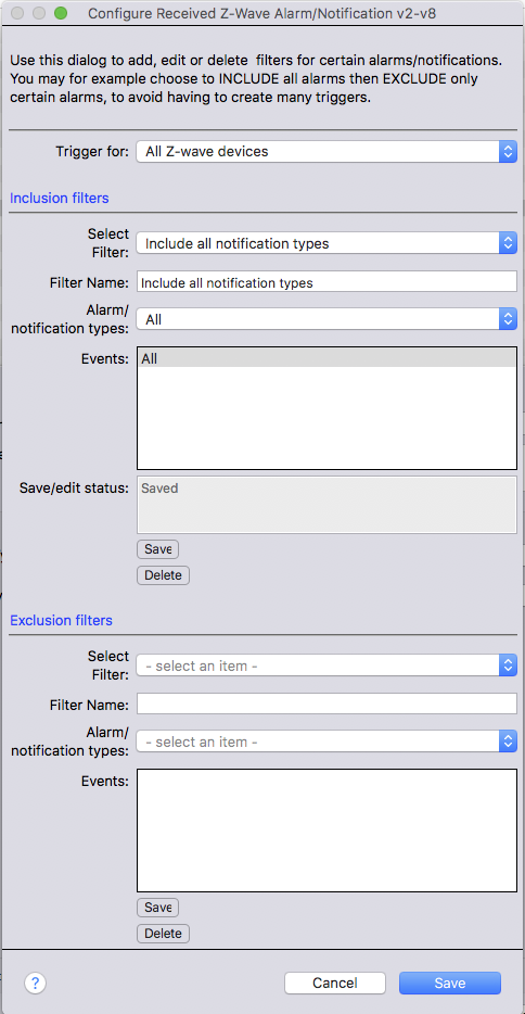

Since the z-wave notification reports are not currently visible in the Indigo logs, it might be a bit difficult to know which devices send which kind of notification reports. To get started and understand which devices send which notification reports, a trigger similar to the one below can be set up:
Skjermbilde 2017-11-30 kl. 23.14.00.png (148.92 KiB) Viewed 4020 times

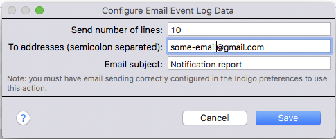

Then an action for example like this can be added to the trigger:
Skjermbilde 2017-11-30 kl. 23.20.21.png (51.8 KiB) Viewed 4020 times

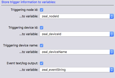

Alternatively, in the plugin options you can set up variables that will be updated with the information on the triggering event and device:
Skjermbilde 2017-11-30 kl. 23.23.07.png (60.3 KiB) Viewed 4020 times
This allows you to use the variables to send more formatted e-mails or notifications.
Once you start getting "spammed" with notifications, you can continue to update the trigger with exclusion filters for the notification reports you don't want to trigger.
