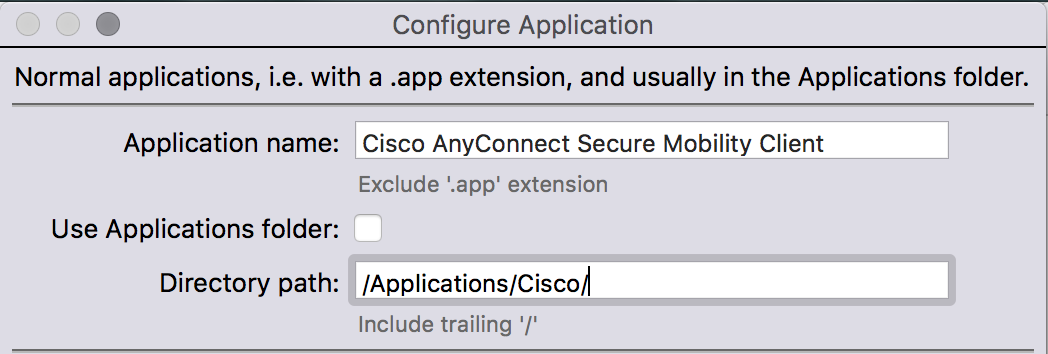

You may still have the folders wrong. I think the first part should look like this.
Screen Shot 2018-01-14 at 9.00.05 AM.png (73.14 KiB) Viewed 6750 times

yes that is also working did that thanks
