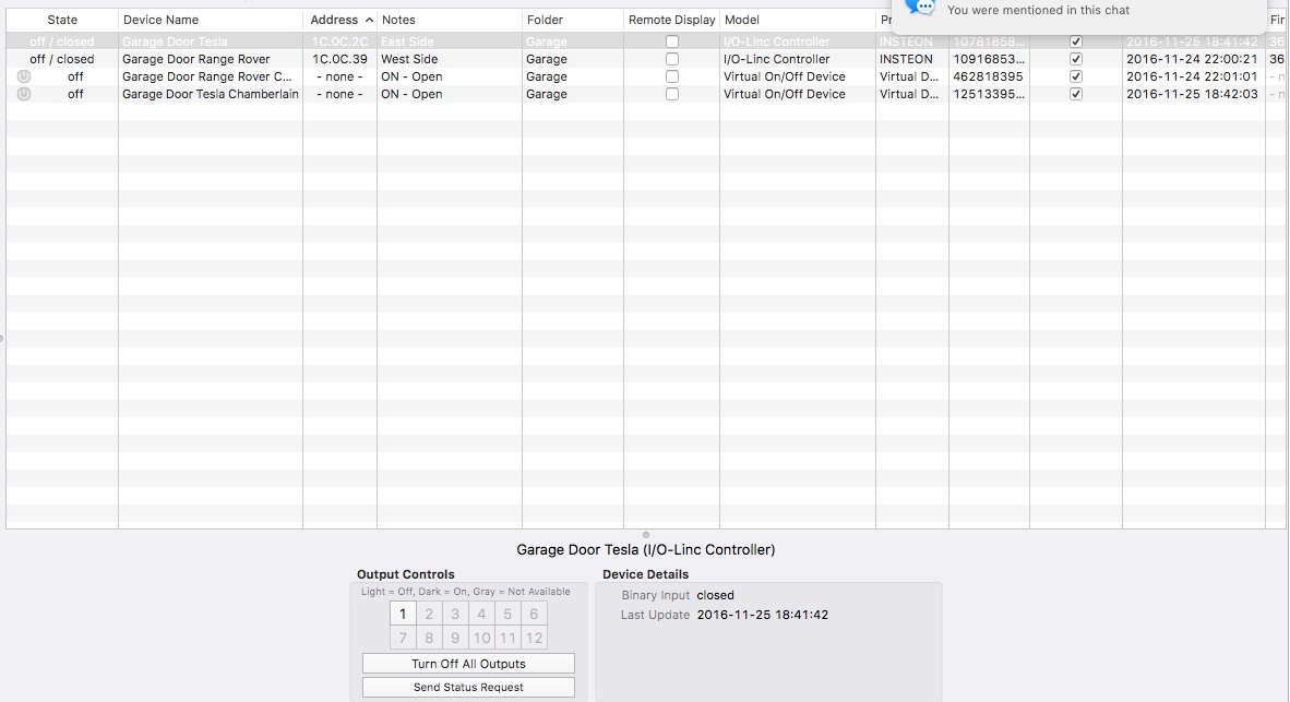

I gave that a shot - the IOLincs I used to monitor the door status aren't in the device list. Basically they're a binary input that's open/closed.FlyingDiver wrote:Darn. I thought I fixed that. Do you have sensors linked to the doors? You edit the device to assign them.

So how do they show up in Indigo? Not as sensor devices? I grab all indigo.sensor devices for the list.Bollar wrote:I gave that a shot - the IOLincs I used to monitor the door status aren't in the device list. Basically they're a binary input that's open/closed.

I don't know for sure - I think of them more as relays, since they also have an output.

OK, that's an iodevice, and adding that would also require that I implement a way to identify the state to monitor. Doable, but not quickly.
Are there any custom states for that device not shown in the standard UI?

No, what you see is what you get.FlyingDiver wrote:OK, that's an iodevice, and adding that would also require that I implement a way to identify the state to monitor. Doable, but not quickly.
