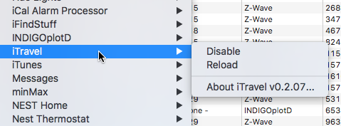

Sorry Mike, still no joy for me, see the attached pic,
Screen Shot 2016-08-26 at 21.06.44 copy.png (53.04 KiB) Viewed 6463 times

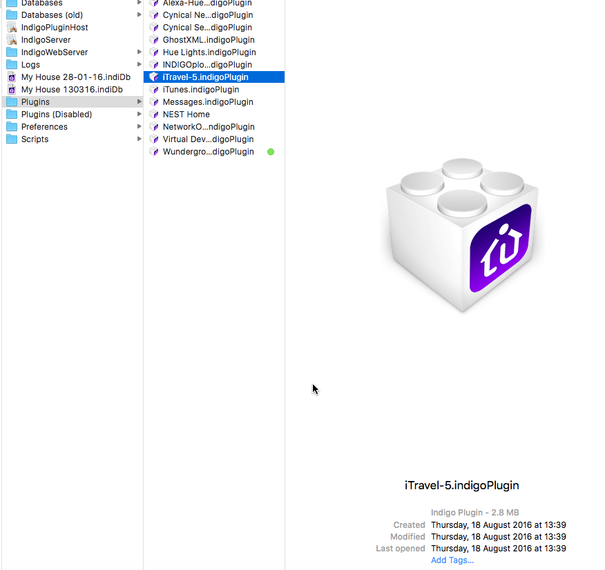

Other things i've spotted - i have a file in the /Library/Application Support/Perceptive Automation/Indigo 6/Preferences/Plugins/ folder called
com.corporatechameleon.nestplugBeta.indiPref - this is the only one with your name on it - could it be affecting the installation of the Travel file?
The plugin i'm downloading and installing was created in Aug 18th - am i getting the right plugin? It says v0.2.14 when i install it.
We'll get there, happy to keep trying :) are others having the same trouble?
Cheers
Martin
Screen Shot 2016-08-27 at 11.05.25 copy.png (139.32 KiB) Viewed 6364 times
