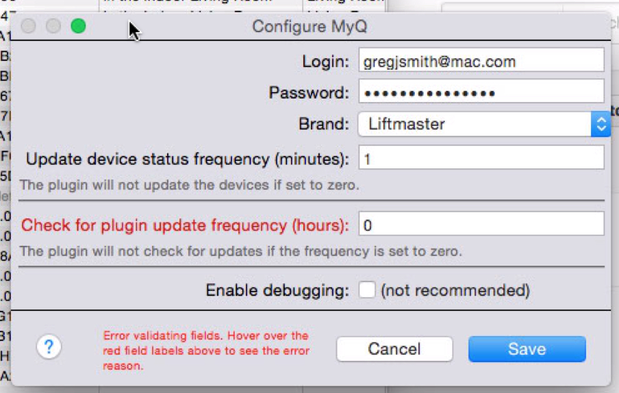

No matter what I put in this field it turns red.
Screen SharingScreenSnapz002.jpg (368.23 KiB) Viewed 7135 times

Oops. I'm highlighting the wrong field. It's actually complaining about the field above that, the minimum is 5 minutes for status updates. This is on the recommendation of the developer of the original code, as we're using an unofficial API and very frequent updates might cause the API to get restricted.
I'll fix the highlighting in the next release.

Even if I leave frequency to the default 10 it complains and won't let me save.

I've gotta figure out a more bullet proof way to do initial startup before the config window is completed.
Grab v.0.03.
