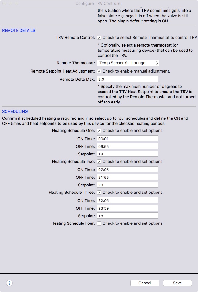

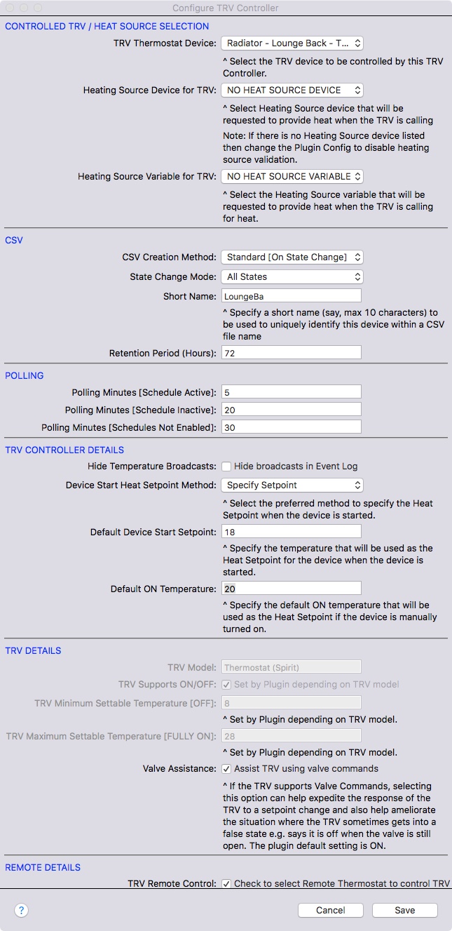

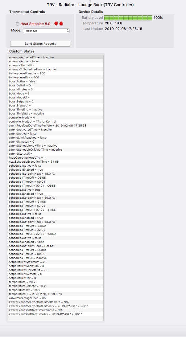

@autolog
Added New TRV Controller for Lounge Back Radiator TRV and set it up as..
And it immediately changed the set point 8C
What am I missing here?
Any ideas - how do I get it to use the set point for the current time period?
Any ideas? Thanks
autolog
Posts: 4077
Location: West Sussex, UK
Post by autolog »
It is working OK but I can see it could be / is confusing. :?
Thanks for providing all the screenshots - makes it easy to see what is going on. :)
The Remote is reading 20.2 which is above the desired setpoint of 20.0. The plugin has therefore reset the setpoint to 8 as it has turned the TRV off. and replicates this in the TRV Controller.
I will take a look at this and see what I can do to make this clearer but it probably won't be until towards the end of next week at the earliest.
It is using the setpoint for the current period because Schedule2Active is true and the schedule2SetpointHeat is 20.

autolog wrote:It is working OK but I can see it could be / is confusing. :?
Excellent - I get it - the SetPoint is set low to achieve an Off - ok
Spooked me there :-)

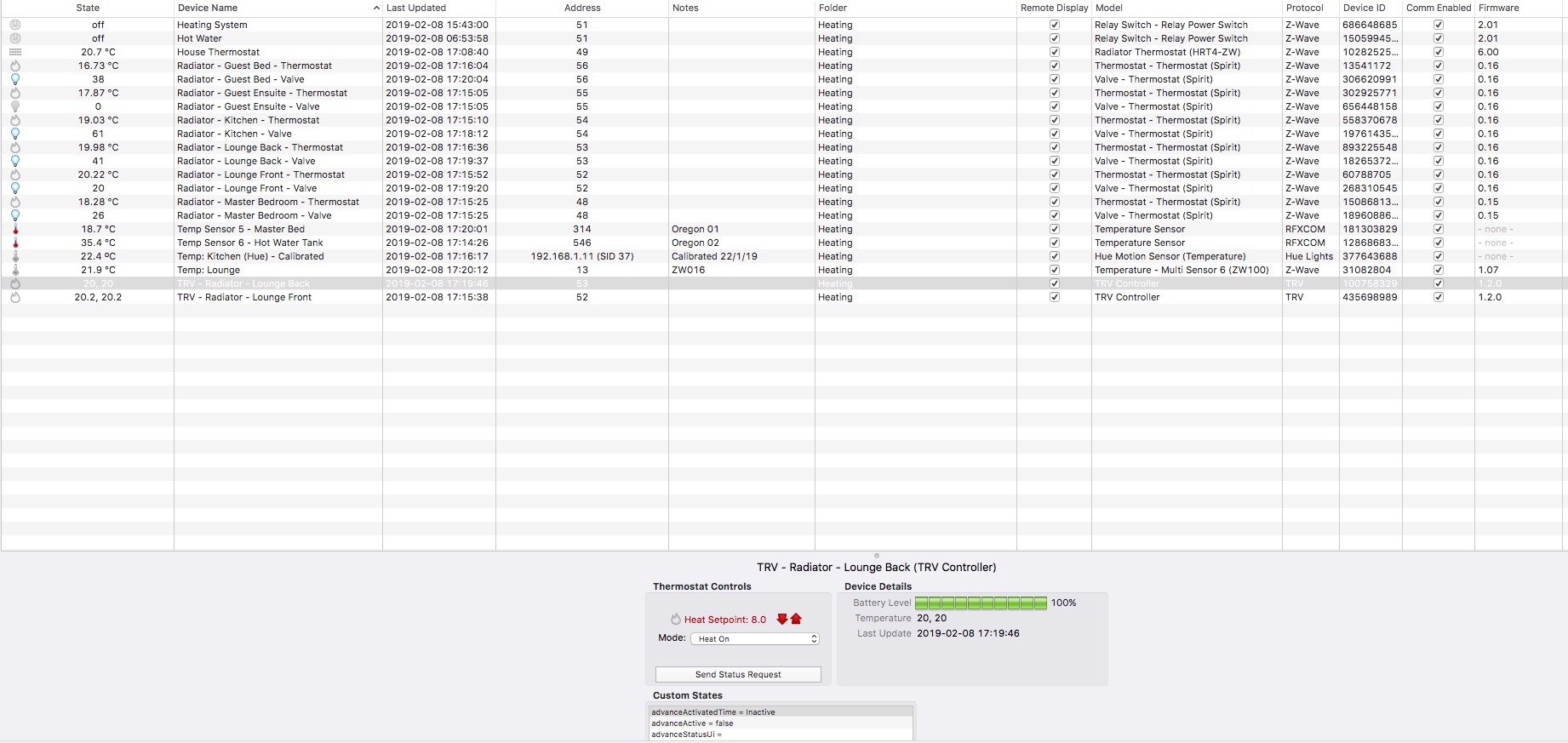

Busta999 wrote:How do I add a Hue Motion Detector - Temperature Sensor to the Remote Thermostat?
I presume from your question that the Hue Temperature device doesn't appear in the list of remote stats? Is it a plugin device?
Busta999
Posts: 714
Location: Wales UK
Post by Busta999 »
Hue Temp Sensors not showing up.
They are coming from the Hue Plugin.
Some of the Temp Sensors
autolog
Posts: 4077
Post by autolog »
Can you print out a device definition via the main plugin menu > open scripting shell. Then try:
dev = indigo.devices[<ID OF SENSOR>]
indigo.server.log(u'SENSOR:\n{}'.format(dev))
This should, if I have got the code right, dump the device details to the Indigo log. I can then take a look at what needs to be done to support them. :)
