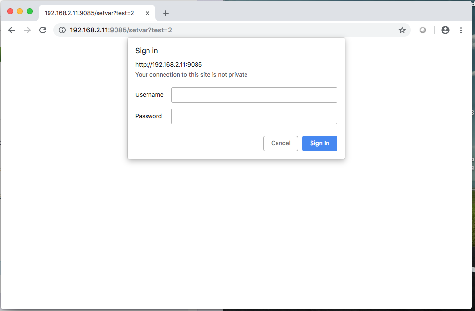

Joe,
So if I paste this into the browser on my mac
http://admin:[email protected]:9085/setvar?test=2
I get the following in my browser
Safari can’t open the page “192.168.2.11:9085/setvar?test=2” because the server unexpectedly dropped the connection.
This sometimes occurs when the server is busy. Wait for a few minutes, and then try again.
But I get this in the event log with debug turned on
HTTPd Debug AuthHandler: GET from 192.168.2.145:54610 for /setvar?test=2
HTTPd Debug AuthHandler: Request has correct Authorization header
HTTPd Debug AuthHandler: setting variable httpd_test to '2'
HTTPd Debug AuthHandler: GET from 192.168.2.145:54611 for /setvar?test=2
HTTPd Debug AuthHandler: GET from 192.168.2.145:54612 for /setvar?test=2
the variable does get set.
when I do the SAME THING on my iPhone (where I really want this to work) even while Im on the local network I get a login prompt (image attached)
why do you think that happens ?
Philip
Philip
- httpdtest.png (62.06 KiB) Viewed 5088 times
- Posts: 7830
Re: HTTPd Plugin (useful for IFTTT Maker integration)
Testing the plugin using a browser is not recommended. Use curl in a terminal window.
In any case, are you using the latest version of the plugin, which was released 4 days ago? I fixed a bug that was causing it to not return a complete web page. Which curl doesn't care about, but browsers do. But then, Webhooks like IFTTT don't care either.
What are you trying to do in your iPhone browser with the plugin?

So, are you using the latest version of the plugin?
Also, the screen shot you show doesn't have the login info in the URL. If you put it there but either Pushover or Safari stripped it out, then you've got a problem.
