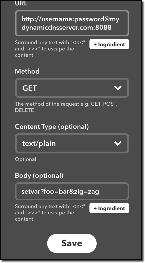

No luck yet, Joe. The IFTTT applet is firing, but I don't see any indication of anything happening in the Indigo event log and no variables are being created.
The screenshots show the fields available when configuring the IFTTT applet using the Maker service and the type of web action available.
Any ideas?

Same result I'm getting. The plugin works, as evidenced by the curl commands running in Terminal. But there's something about the IFTTT channel action that's not working. And I can't find anything on IFTTT about how to troubleshoot those actions.
Oh, and the setvar, etc needs to go on the end of the URL, not in the request body.

On IFTTT, the "Make a Web Request" part of the applet is:
URL: http://<username>:<password>@<your computer address>:<port>/setvar?<variable>=<value>
It's the same format I posted before. It was always correct, I think. The only thing that's really variable is the port number. Most anything you're not already using over 1024 should work, I'm currently using 5555.
Method should be "GET". Content Type should be "test/plain". Body should be empty.
Now set up the plugin. You need to specify the username and password that you're using in IFTTT. You also need to specify at port number. You can use the same port number for external (IFTTT) and internal (the plugin), but you don't have to unless your router doesn't handle translating the number. Some seem very limited that way.
