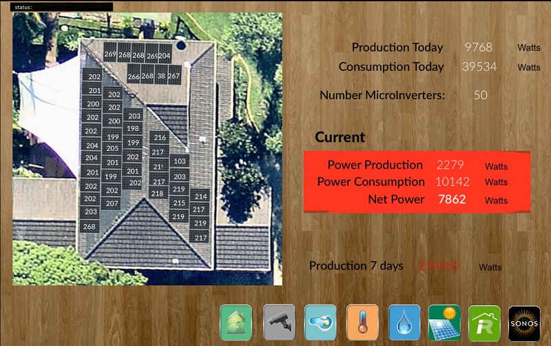

Great to hear.shmigator wrote: Now to just figure out a cool way to show it on a control page ....
This is my control page - which also turns on/off pool heating depending on power production/usage.
(as essentially no point exporting power back to grid as no $)

Re: Enphase Envoy-S Solar Power Plugin (with Panel Monitorin
That looks great.
I was thinking something similar but with colors kinda like a heat map.
Like the picture attached fore now, hoping I can figure something out with a much wider range of colors.

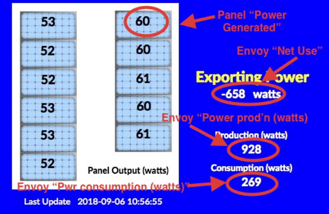

Great plugin thanks Glenn!
Just commissioned an 11 panel system and integrated with Indigo V7.1.1 using your plugin V0.1.6 which was quite straightforward. - thanks!!
However, having developed a control page for the system I am a bit puzzled by the results.
Referring to the attachment, I have displayed the output of each panel using the control panel custom state "Power Generated Watts" and the Envoy output using the "Power Production (watts)" custom states. You will note that the individual panel outputs reported by each of the IQ7 micro inverters do not sum to the production figure reported by the Envoy-S. The discrepancy seems higher than losses and metering errors that might occur.

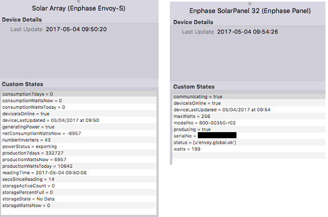

On delving into the Custom States and other aspects of the plugin, there are also a few more queries:
- The Custom States listed for each of the panel devices do not correlate to the states presented when editing a control panel. Is this a plugin, Indigo or operator issue? For example, when designing the control panel I have selected the "Power Generated" device state although the Custom State on the panel device is "watts".
- The Custom States for the Envoy-S also do not correlate directly with the device states for the Envoy device on the control page. I am also a little confused by the states for daily figures. For example am I correct in assuming that the device states such as "Power Production Today (watts)" is actually in watthours and not watts?

Thanks for the feedback.
Working through your issues:
The panels can only be updated every 10 minutes or so, whereas the consumption/production is updated much more frequently (?60 seconds)You will note that the individual panel outputs reported by each of the IQ7 micro inverters do not sum to the production figure reported by the Envoy-S. The discrepancy seems higher than losses and metering errors that might occur.
So there is often a difference depending on shading and what changes you might be experiencing in that time.
If you enabled debugging - you will see when the large panel data is pulled and can check then.
Should equal each other.
By design.- The Custom States listed for each of the panel devices do not correlate to the states presented when editing a control panel. Is this a plugin, Indigo or operator issue? For example, when designing the control panel I have selected the "Power Generated" device state although the Custom State on the panel device is "watts".
Perhaps could be clearer.
But the control panel/trigger can have different longer explanations rather than just the states
But yes state watts = Power Generated
