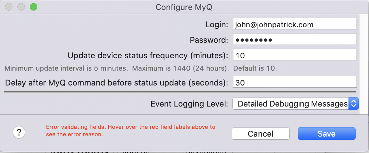

Yes, it is repeating continuously. I can't turn debugging on because the dialog says there is an error. There is nothing wrong with my credentials.
- Screenshot 2019-10-29 18.35.09.png (218.82 KiB) Viewed 4480 times

- Posts: 7823
Re: MyQ API down again
If you can't get out of that dialog, then your credentials aren't authenticating.
Have you tried them with the current MyQ app?
The credentials work in the app and also the web site.

- Posts: 7823
Well, crap. Looks like MyQ changed something in the API. I've been getting those errors too.
