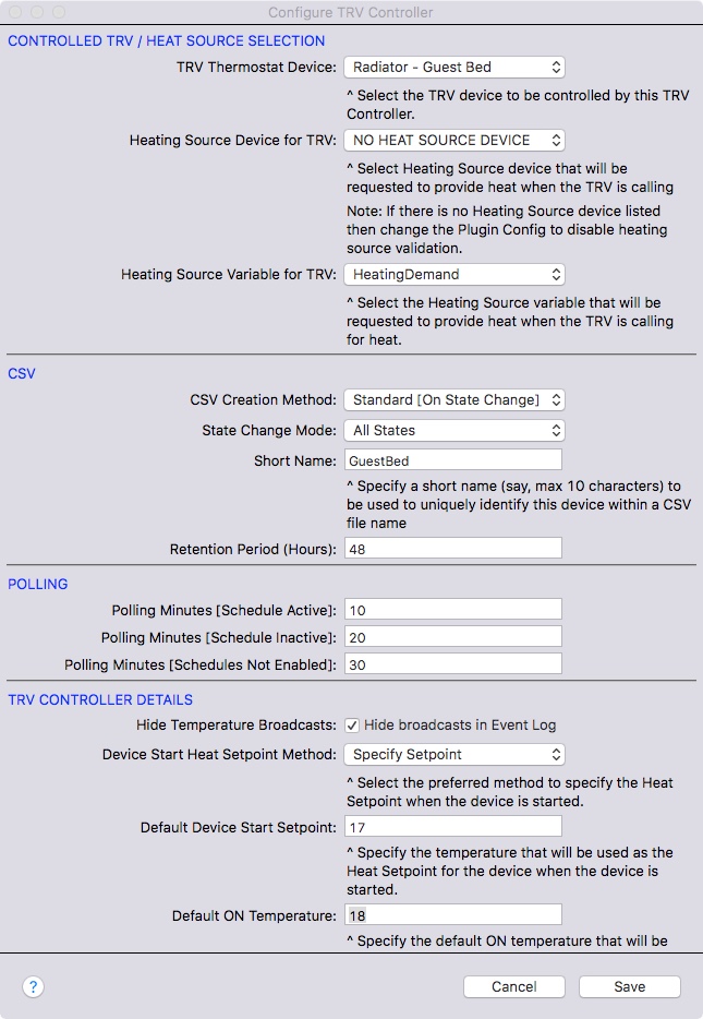

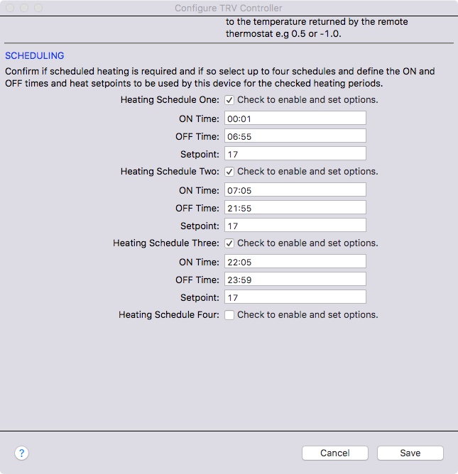

Autolog happened again
Noticed the Guest Bedroom running low - too low
It appears that the TRV device has Heat Turned Off when I would expect it to be On
MacOs 10.12.6
Indigo 7.4.0
TRV Plugin 1.3.1
Indigo TRV Mal 1.jpeg (105.81 KiB) Viewed 4053 times
Indigo - TRV Mal 2.jpeg (124.76 KiB) Viewed 4053 times
Indigo Config - TRV 1.jpeg (184.05 KiB) Viewed 4052 times
Indigo Config - TRV 2.jpeg (189.03 KiB) Viewed 4052 times
Indigo Config - TRV 3.jpeg (93.39 KiB) Viewed 4052 times
Busta999
Posts: 714
Location: Wales UK
Post by Busta999 »

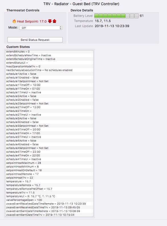

It looks like the Setpoint for each schedule is getting lost between the config screen and the actual settings?

Busta999 wrote:It looks like the Setpoint for each schedule is getting lost between the config screen and the actual settings?
I don't understand what you mean - what is getting lost? :?

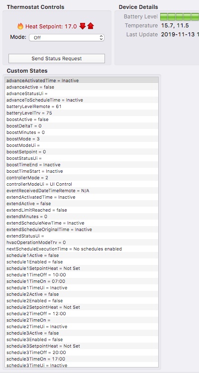

The Custom States show set points as Not Set
But when you select the Edit Device Settings it does have Set Points set.
I think I know how /why this may be happening. Looking into it now - it could be a Guest Mode I am using that sets the Guest rooms up for visitors..

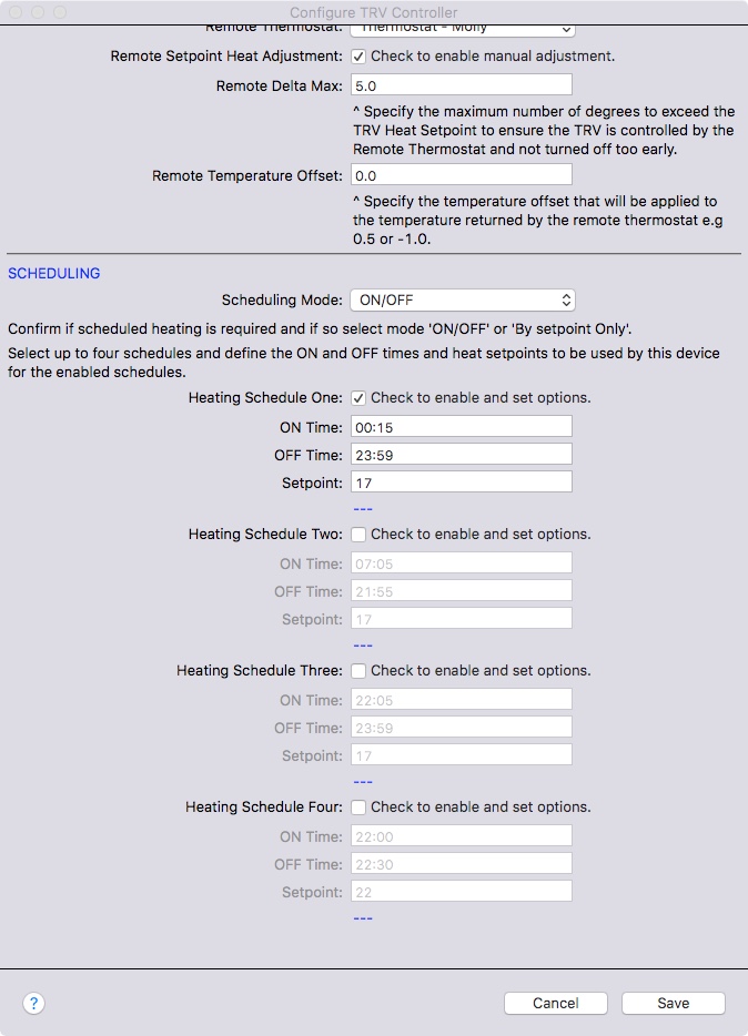

Running the Test 1.4.0 plugin
Adjusted 4 of the Spirit TRV settings yesterday after the rouge Sprits reported earlier.
Dropped them down to a simple 1 Schedule below:-
Indigo - TRV Scheduling issue.jpeg (148.48 KiB) Viewed 4036 times
I had expected to just maintain a steady 17C throughout the day.
Instead it dropped all four rooms to a target set point of 8C.
I found the rooms this morning at 15C then did a manual override on the Thermostats - that stabilised things.
But I suspect that the TRV Plugin will force them back to 8C again.
Any suggestions/pointers on what I have done wrong here and how to fix it?
autolog
Posts: 4077
Location: West Sussex, UK
Post by autolog »
Busta999 wrote:... Any suggestions/pointers on what I have done wrong here and how to fix it?
I don't think it is anything you have done :)
Continuing debug discussion via iMessage. :)
