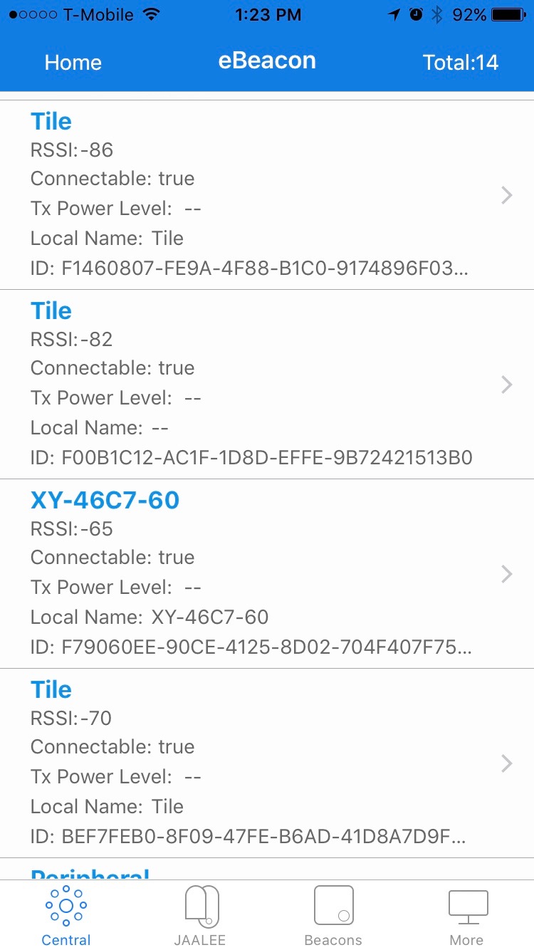

Karl,
Using eBeacon on my iPhone, I can see three Tile, which is all the tiles that I have. (see enclosed screen from eBeacon). The three include the new slim Tile and newly replaced regular tile. However, only the old regular tile shows in piBeacon.
Why do I have Tile? Simple, wife wants them for her keys, wallet and purse...not fighting a battle lost before it even starts...for my stuff, I use xy.

I tried ebeacon. No success. Will try again.
Do you have tile ble access on when title not active?
Re: piBeacon: 7- tested Beacons
ok I have the tileSlim(e) now too on ebeacon.. don't know why they do not show up.. this will require some deeper dives

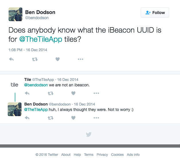

tiles are not really iBeacon, but it works somehow. will need to add scanning for all BLE signals and then find how tile does it

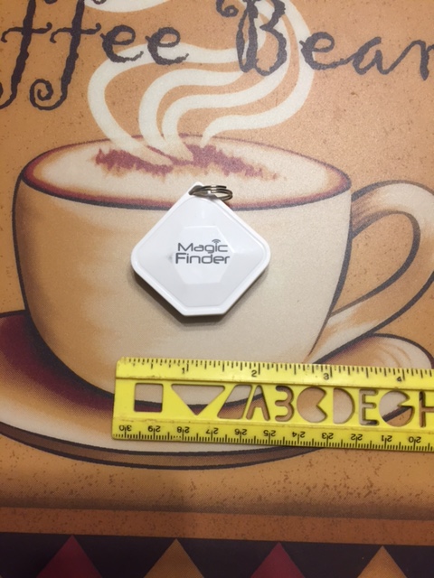

Another beacon you can add to the list; these Magic Finder beacons from Office Depot (and likely elsewhere)
http://www.officedepot.com/a/products/5 ... vice-3-34/
for $13 US work fine. They're a bit bigger than the FinditXYs, and I don't know how long the battery lasts since I've only had this one a week, but it has a screw off port on the back to easily replace the 2032 when it does die.

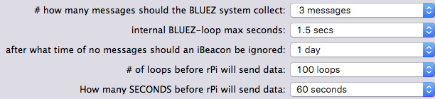

AND these setting for the iBeacon detection seem to work a little better (faster) and less skipped iBeacons(*): Karl
a beta is here:https://www.dropbox.com/s/wqyc0oi6g8bmq ... 3.zip?dl=1
(*) this setting will give it just a little bit more time ~0.5 secs and will do 2 loops to bluetooth interactions to get more messages.
